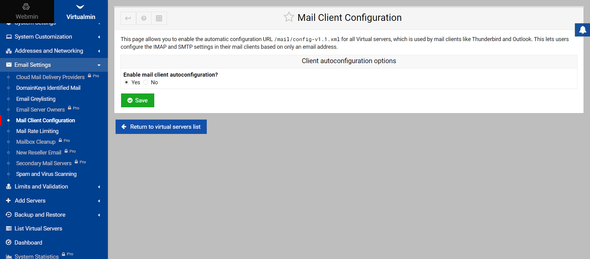

Here is some autoconfig option for which i just add DNS record and add my email in outlook using “Other IMAP/POP Account” and it autoconfig the IMAP, SMTP
