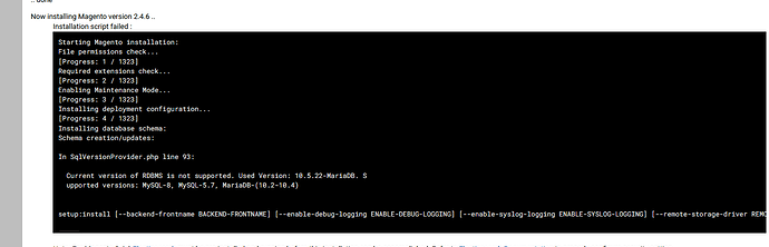

I just did a test, install script had a error

Did the script errored like mine?

I had 8.1 on the test server. Did you get the error?
I just notice this when I tried reinstalling.
Did you install that?
Maybe the install scripts needs to be looked at.

I just did but script still fails. I think my issue is the database version on the script error.
