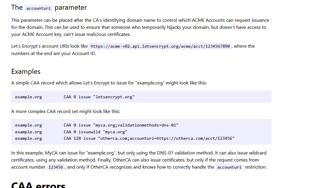

P.S. Is it this record?
CAA - Certificate Authority 0 issuewild letsencrypt.org
No, that’s wildcards, which must validate with DNS. Most folks don’t need a wildcard and most folks don’t benefit from a wildcard, and wildcards have security implications.
If Virtualmin is managing your DNS, it will automatically validate via DNS if web validation fails. It is not an option you choose. It just does the thing.
Wildcard certs are unrelated to your question. Wildcards must be validated via DNS, but that has nothing to do with getting a regular cert. For regular certs, Virtualmin will try both, if both are available (i.e. if you have a website and if Virtualmin is managing DNS). If web fails, DNS will be attempted.
Ok, so leave this record will work as a fallback?
Maybe not, seeing there is a issuewild there.

I think going on the docs
example.org CAA 0 issue "letsencrypt.org"
Would do the job

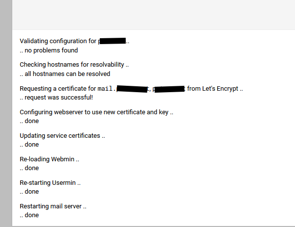

Just tried on a spare domain, turned off web service and worked fine.

I tested it manually, and it works - also much faster than http renewal, but all my DNS is on separate servers and VMin doesn’t manage it.
