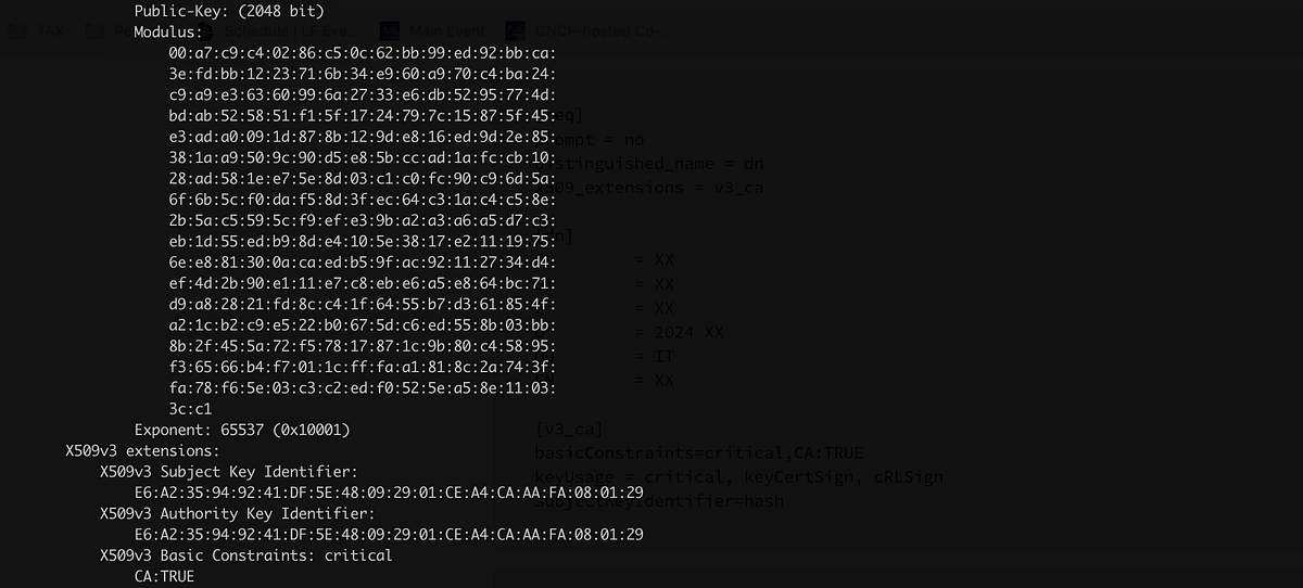

CAcert runs it’s website very well with https - but:
The browsers complain about all sites whose root certificate is not already pre-installed in the browser. Either you trust the browser that it has only installed trustworthy root certificates and hope that it has pre-installed all trustworthy root certificates. In the other case, you can install a root certificate yourself. For example, if you trust CAcert, install the root certificate from CAcert. Your browser won’t say a peep; as loud as it shouted before, it will trust your decision afterwards.
CAcert certificates are therefore suitable for internal applications, e.g. branch office → head office, etc. but not for sites with ‘walk-in customers’, as these usually do not have the CAcert root certificate installed.
CAcert’s root certificate can be found here https://www.cacert.org/index.php?id=3
you can also go the the cacert.org website and click on the menue “root certificate” (maybe in your computer’s language; on the top right), it will you proceed to the same page.
