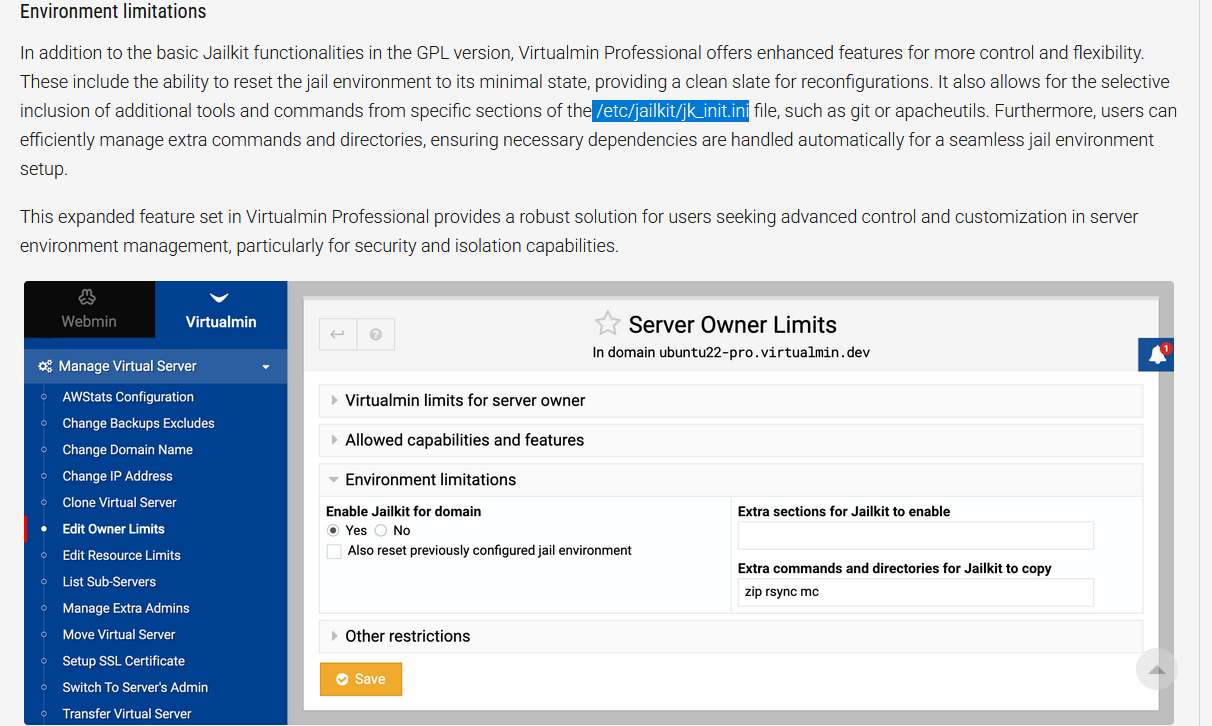

Check the docs, the pro version and a section for allowing extra command and directories and writes to the /etc/jailkit/jk_init.ini file.

As I’m using GPL not Pro I don’t have those additional options unfortunately.

yeah I know, just saying the file pro changes is /etc/jailkit/jk_init.ini
Unless pro is doing something with different jailkit then you should be able to edit this manually.
