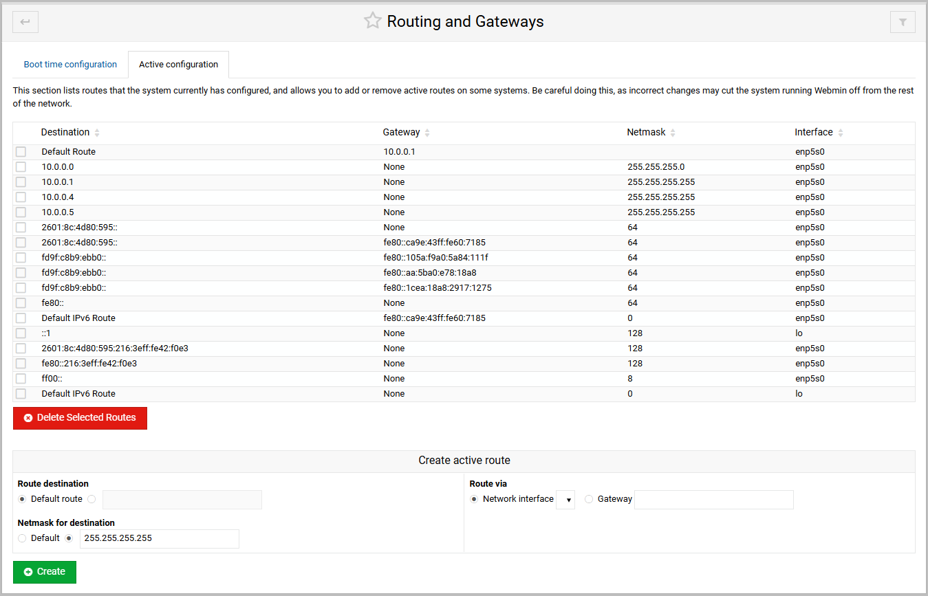

This may be a local networking issue - I just realized I can’t ping my Host’s IP from within the VM.
This is my Networking information inside Virtualmin. It’s a VM that is hosted on a TrueNAS system, and it’s assigned an IP of 10.0.0.240. I can resolve it, ping it, etc. from the outside, and the VM can reach sites outside my network without issue (i.e. - I can pull down updates, scripts, etc.). The one thing I can’t do is ping the host TrueNAS at 10.0.0.253

So, here’s the challenge… I can’t ping the host (10.0.0.253) from inside the VM running Virtualmin (10.0.0.240).
I think the proxy issue is a symptom of a larger issue, which is networking. The VM can talk to the outside world, just not its own host for some reason.
I made a test VM and installed Debian from scratch, and nothing else. From that VM, I can ping my router, but not the host, so the issue is not Virtualmin. I’ll work to get this resolved over on the TrueNAS forums, then come back here to confirm when it’s done.
This wound up being a configuration issue with the NIC / Bridge used to set up the VM that Virtualmin is running on. It’s resolved now, and we’re back in business.
