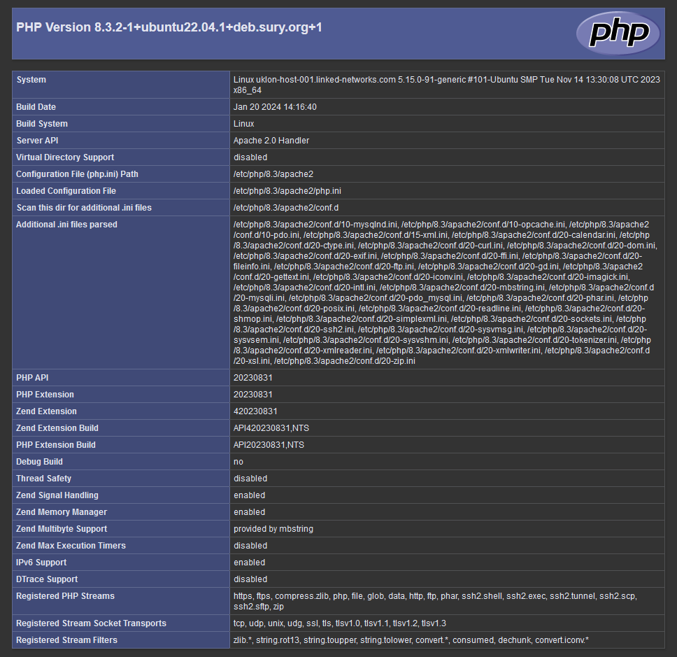

So when you switch to 7.4 you can check the version by clicking on the php icon and it will display phpinfo() for that virtual server. Is it showing 7.4 in that link.
Hi Stefan,
Mine looks a little different to yours and doesn’t have that icon / option. See below:
Sorry Just found it.
PHP Version 8.3.2-1+ubuntu22.04.1+deb.sury.org+1
Which is interesting consideing you can see 7.4.33 is selected!
