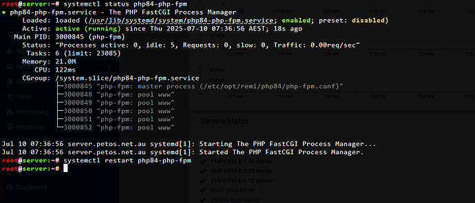

What error is produce when you do a restart, works fine on my Rocky 9 server
Thanks for your reply!
I can confirm that the services restart correctly on my system too — no visible error from systemctl restart phpXX-php-fpm.
However, the problem is that after the restart, the socket file (e.g. /run/php-fpm/xxxxx.sock) disappears and doesn’t get recreated. As a result, any virtual server using that PHP version through FPM immediately starts returning 503 Service Unavailable errors due to the missing socket.
If I restart the same PHP-FPM service from Virtualmin’s UI, everything works perfectly: the socket is recreated and the sites respond correctly.
So the issue isn’t with the service failing to start, but rather with the socket not being created unless the restart is done through Virtualmin.
Thanks again for your help!
