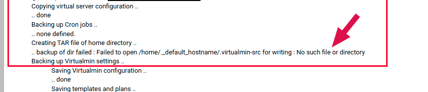

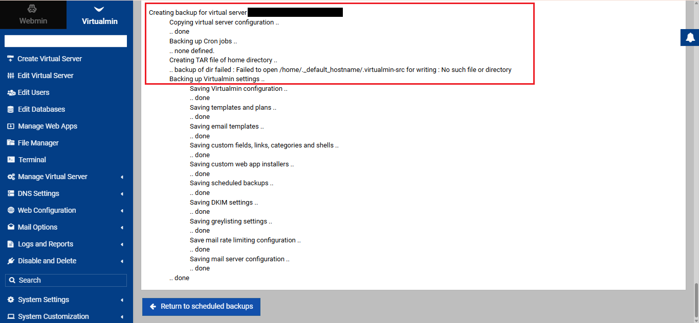

I recently changed my server’s hostname and default domain in Virtualmin. Since making these changes, I’ve been unable to create a complete server backup. When I try, the process fails and I receive an error — I’ve attached a screenshot of the backup log showing the issue.
Has anyone experienced this before, or can someone help me troubleshoot what might be causing the problem?

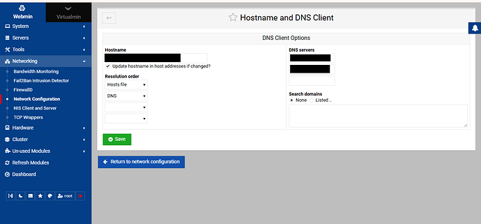

I followed the steps from the Virtualmin forums and also changed the hostname directly from the server’s terminal.
Everything has been working fine for almost two weeks now, except for the backup.

as you can see from the arrow the folder virtualmin can not find the directory that the default domain is expected to live in. Are you hosting a domain in virtualmin with the same name as your hostname ? If so you shouldn’t do that as it will give you all sorts of odd problems.

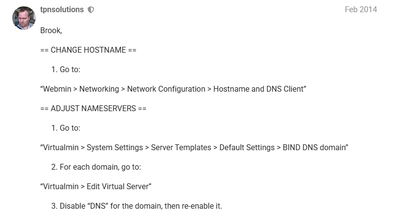

One of the forum which I followed:
This does not explain why the path /home/_default_hostname is being referenced on my vm system that path doesn’t exist and all domains are located in /home/<domain_owner>, so how did you rename the domain ?

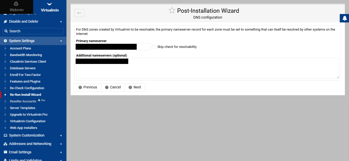

I also updated the nameservers for the new domain and replaced the previous default hostname with the new one from these as well.

I believe I may have accidentally deleted a folder named something like ‘defaulthostname’ from the home directory, which was listed alongside all my virtual server folders.

These ones
Thanks, @tpnsolutions is usually very reliable.
So I would expect that to work.

Thank you all for your support. I tried searching and adjusting various settings, but nothing resolved the issue. In the end, I had to reinstall Virtualmin and restore the backups.
