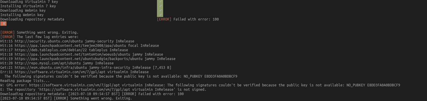

Is the installer a bit broken at the moment ? (NO_PUBKEY E8DD3FA0A0BDBCF9)
OS type and version Ubuntu 20.04
Webmin version N/A
Virtualmin version N/A
Tried to do a vmin install today & got this
We need @staff to get onto this. Seeing a few reports. I’ll do a Rocky9 install right now.
The installer isn’t broken. The apt repo was. Should be fixed now.
This is not a Rocky problem.

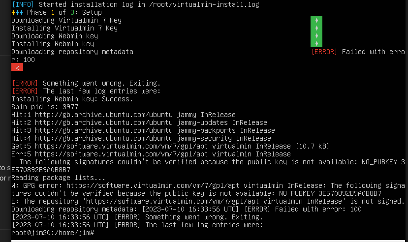

not at the time of this post
What happens if you do apt clean; apt update?
No change after running those commands
I’m confused. I can’t reproduce the problem, currently. I was able to see it happening early this morning, but after I republished with the right key, the problem went away for me.
This is a screen shot of what I am seeing if this helps
I can’t figure out where that’s coming from. That’s a different signing key from your original post, but it’s still not the right signing key. But, when I download it on my test instance, it has the right key. I really am confuse by this one.
this was fixed by redownloading the install script … perhaps the original was corrupt
