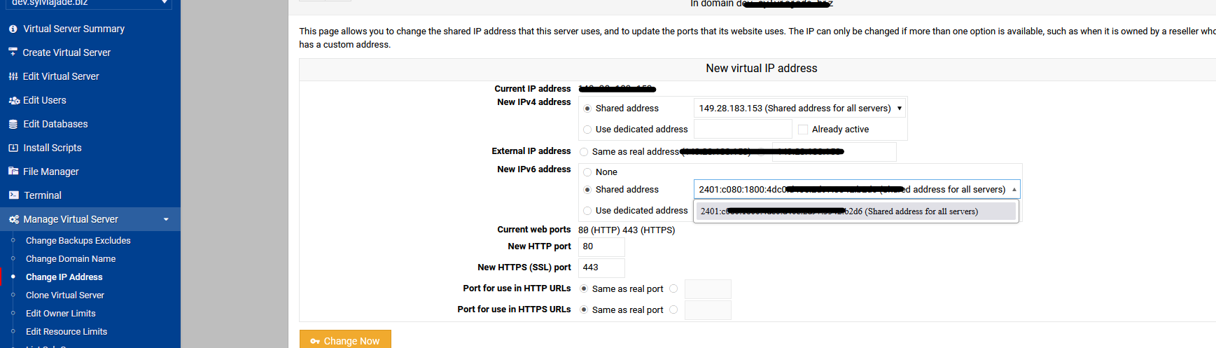

I researched a bit , and think that is because facebook uses ipv6 for this also , and i see that my vhost is not enabled for ipv6 as screenshot . could be because of that?

how can i enable ipv6 for my virtual host? because my VPS have one IPv6 address assigned also.

Check your IP6 address hasn’t changed, go to Change Ip Address on the virtual server and see if there is a new IP, my VPS does it too me sometimes. Very annoying. If it has update and also update the dns.

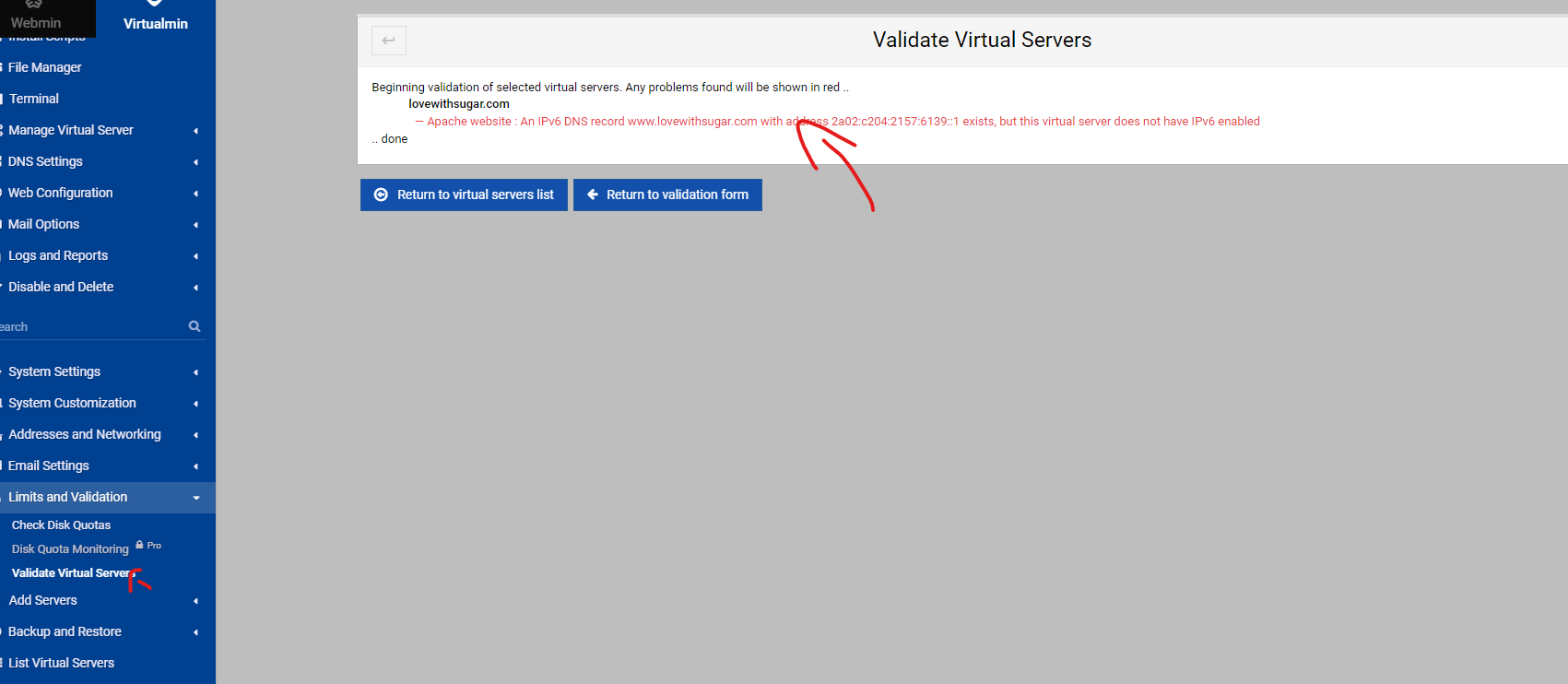

Has Validate Virtual Server issue gone?
