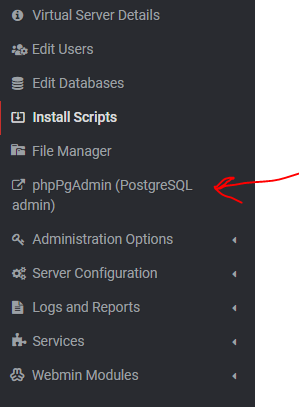

I’m using webmin in browser and I used to have a direction just like phpPgAdmin(PostgreSQL admin) that said phpMyAdmin instead. One day it just disapeared for no reason. I tried to Install it again on Install Scripts where I can still see my mysql db but I get the following error:

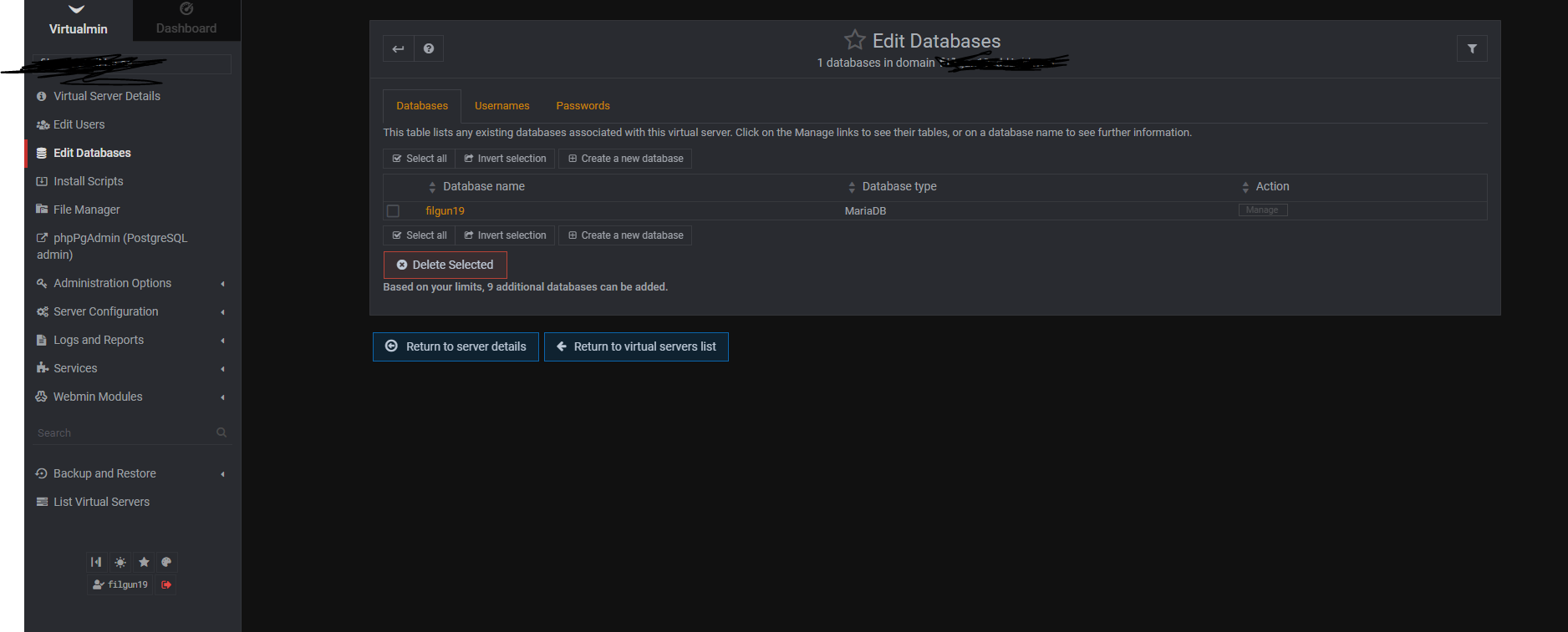

So what do you see when you click Manage under Action.
I can see all my tables in myMariaDb like usual but no tables from my MySql one.

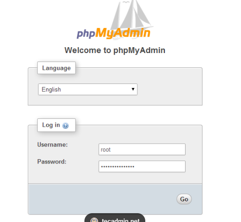

Then I got redirected to a login page like this one with a boat:
:sweat_smile:
Just log in there that is phpmyadmin
It’s just a image from the web I dont know how to get there :melting_face:

  3. I notice you have a pro version, the link to phpmyadmin in the sidebar would have been created by the server admin (you ?), so even if you get phpmyadmin to install you will have to make the custom link yourself
  4. have you tried navigating to where phpmyadmin was installed ? should be something like https://your-domain.com/phpmyadmin or wherever you installed it.

The one to my PostgreSQL link seems pretty hard to guess correct it’s:
https://your-domain.com/phppgadmin_rVSl2/?randomized=26327&xnavigation=1
