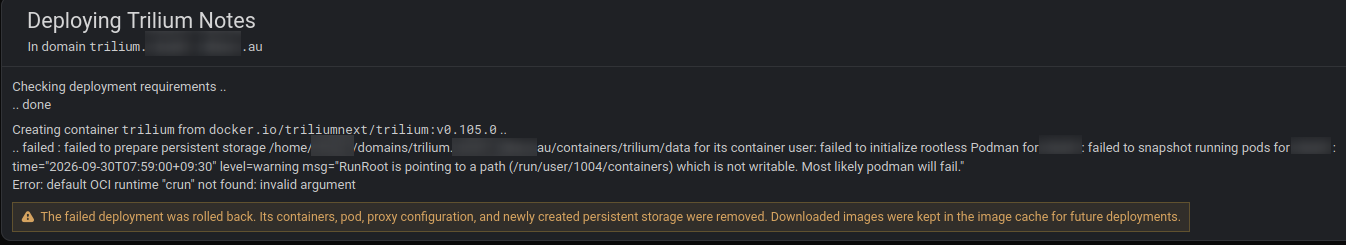

I’m migrating my docker containers from my old VPS to my fresh Ubuntu physical server, and following suggested best practice I have created a few sub-servers off my main domain, to replace the old sub-domain set up I had. I had 3 docker containers on the old server, but I want to use the new Container Manager in Virtualmin to install and manage them on my new server. When I try to run a new recipe, I get this error:
level=warning msg=“RunRoot is pointing to a path (/run/user/1004/containers) which is not writable. Most likely podman will fail.”
The user 1004 is my mail domain user, and has no domain or otherwise connection to the parent Virtual Server, or the sub-server, so it makes sense that it fails. AI is suggesting that I need to add a user as Owner to the sub-server so that the recipe won’t fallback to the first user it finds, but I would rather ask in here because that solution doesn’t make full sense to me. My thinking is that the recipe would have handled that if it was needed? I would prefer to run rootless to keep the containers separated if that matters.
Can anyone shed any light on what I’m doing wrong, or what I need to do to install the recipe please?

Checking deployment requirements ..
.. done
Creating container trilium from docker.io/triliumnext/trilium:v0.105.0 ..
.. failed : failed to prepare persistent storage /home/myserver/containers/trilium/data for its container user: failed to initialize rootless Podman for myserveruser: failed to snapshot running pods for myserveruser: time=“2026-09-29T17:44:02+09:30” level=warning msg=“RunRoot is pointing to a path (/run/user/1004/containers) which is not writable. Most likely podman will fail.”
Error: default OCI runtime “crun” not found: invalid argument

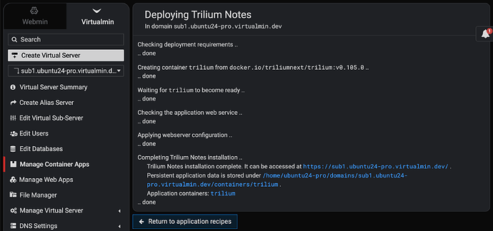

With a standard installation using our virtualmin-install.sh script, you should be able to create a virtual server and sub-server, then install Trilium Notes using the recipe’s default settings, out of the box.
And no additional users or manual Podman configuration is needed!
I’ve just tested the same Trilium Notes recipe on an Ubuntu 24.04 sub-server, and it installed successfully as in my previous tests:

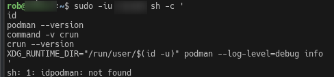

I tried to run the command you suggested, but got this output:
sh: 1: idpodman: not found
Understood!
Ah, dang, sorry. Run it as a one-liner, replacing myuser with your domain owner’s username:
sudo -iu myuser sh -c 'id; podman --version; command -v crun; crun --version; XDG_RUNTIME_DIR="/run/user/$(id -u)" podman --log-level=debug info'
