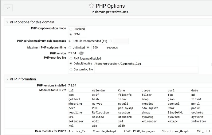

This is PHP Options:

It has nothing to do with PHP configuration. Your application has configured or hard-coded paths that are wrong for your Virtualmin system, and you need to fix that.

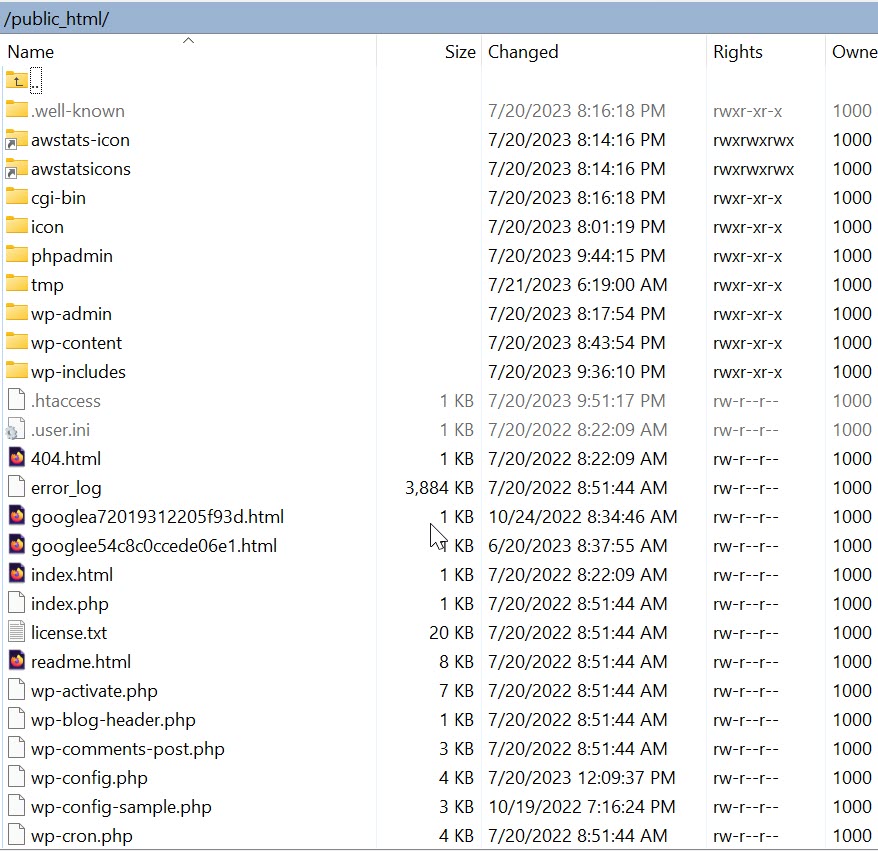

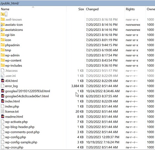

I created /tmp folder inside /public_html folder & restarted server.
But now get the following error:
