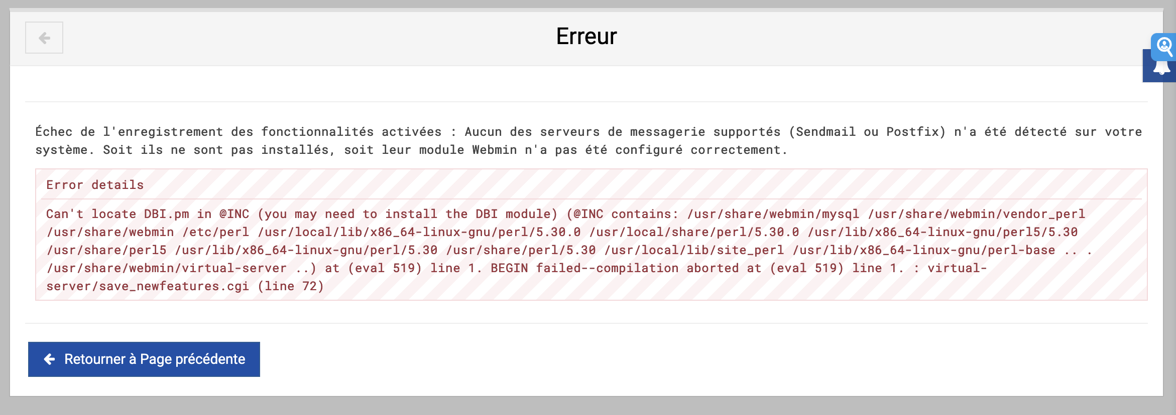

I cant finish my instalation
Hello i have this error please
i cant add mysql

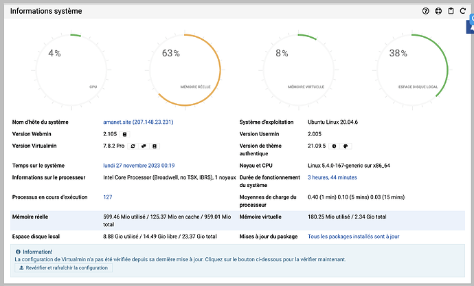

Mr this is a new installation for you to put in image I paid for a vps with ubuntu the version it is mentioned on the text at the bottom and the screenshot and after I launched the installation once it was finished I accessed the server with the port of your system then the hypothesis of deletion is impossible because it is a new installation
amanet.site system information
Nom d’hîte du systùme amanet.site (207.148.23.231)
Systùme d’exploitation Ubuntu Linux 20.04.6
Version de thĂšme authentique 21.09.5
Temps sur le systĂšme lundi 27 novembre 2023 00:19
Noyau et CPU Linux 5.4.0-167-generic sur x86_64
Informations sur le processeur Intel Core Processor (Broadwell, no TSX, IBRS), 1 noyaux
Durée de fonctionnement du systÚme 3 heures, 44 minutes
Processus en cours d’exĂ©cution 127
Moyennes de charge du processeur 0.40 (1 min) 0.10 (5 mins) 0.03 (15 mins)
Mémoire réelle 598.74 Mio utilisé / 125.39 Mio en cache / 959.01 Mio total
Mémoire virtuelle 180.25 Mio utilisé / 2.34 Gio total
Espace disque local 8.88 Gio utilisé / 14.49 Gio libre / 23.37 Gio total
Mises à jour du package Tous les packages installés sont à jour

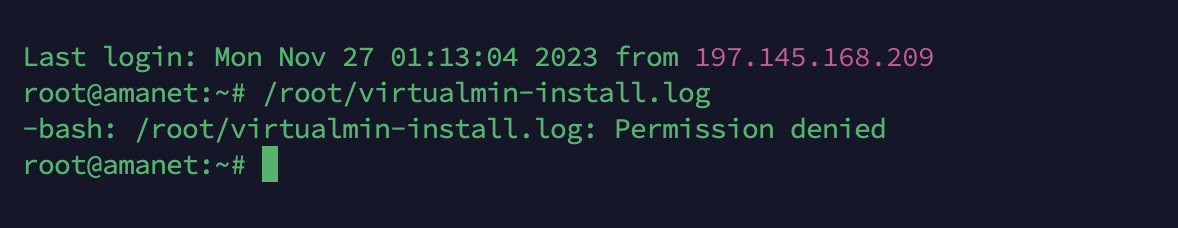

I HAVE THIS BRO
-bash: /root/virtualmin-install.log: Permission denied
You can’t run a log file. It isn’t executable.

OK, I see libdbi-perl and libdbd-mysql-perl were installed, which is what’s trying to be loaded here. So
something is wrong with
your Perl, I guess? I’m confused. Unless they were removed after installation of Virtualmin, of course.

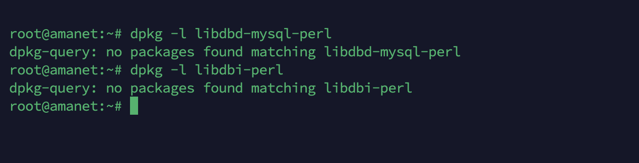

Check:
dpkg -l libdbd-mysql-perl
And:
dpkg -l libdbi-perl

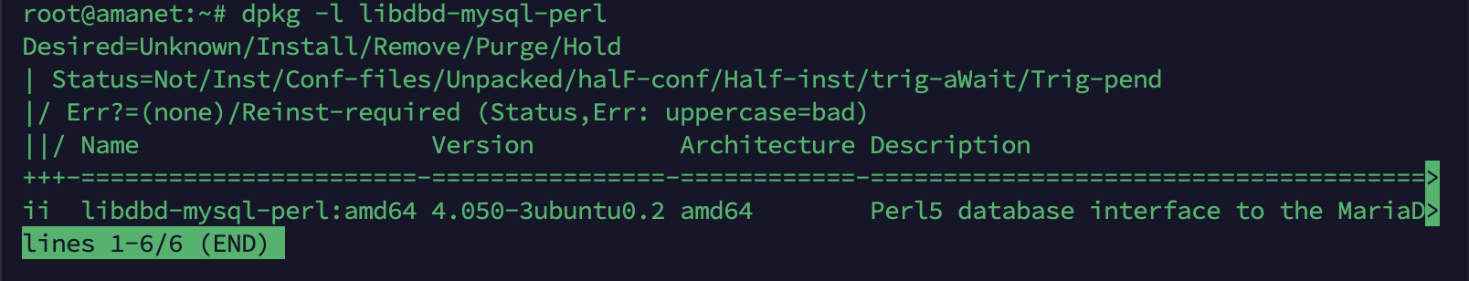

now
and i have this :slight_smile:
Your system status is being checked to ensure that all enabled features are available and properly configured
Your system has 959.01 MiB of memory, which is equal to or greater than Virtualmin’s recommended minimum of 256 MiB
BIND DNS server is installed
None of the supported mail servers (Sendmail or Postfix) have been detected on your system. Either they are not installed or their Webmin module has not been configured correctly.
.. your system is not ready to use Virualmin
Oh, wait. Your installation didn’t finish! I was looking for those packages in the log (and found them), but didn’t scroll all the way down.
It stopped before the package installation step even completed, based on the log.
You should have seen errors or a bunch of steps incomplete. You don’t have a Virtualmin system there. I don’t know what’s missing, but it’s a lot. All of the config steps would have not been done, if it failed during package installation.
