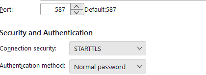

My setting with thunderbird
Check the servers mail log file for the error when trying to connect.

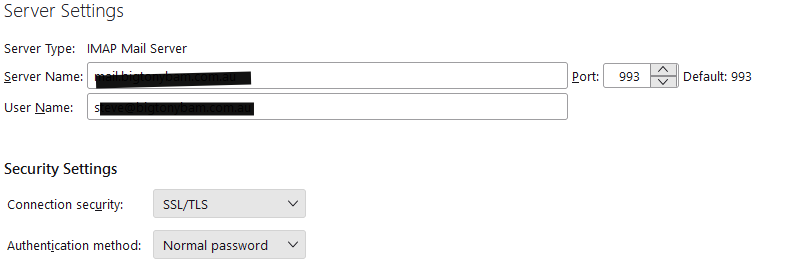

Imap settings

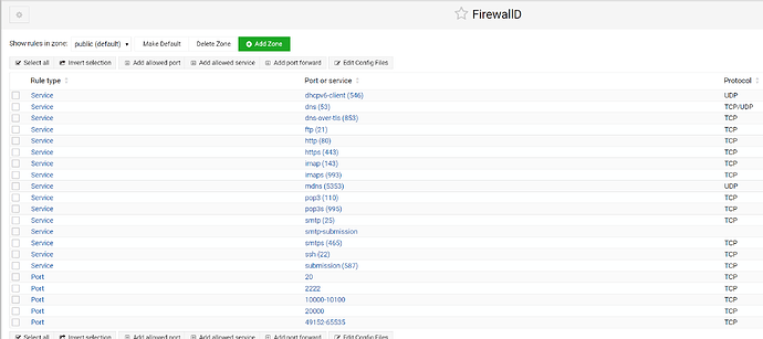

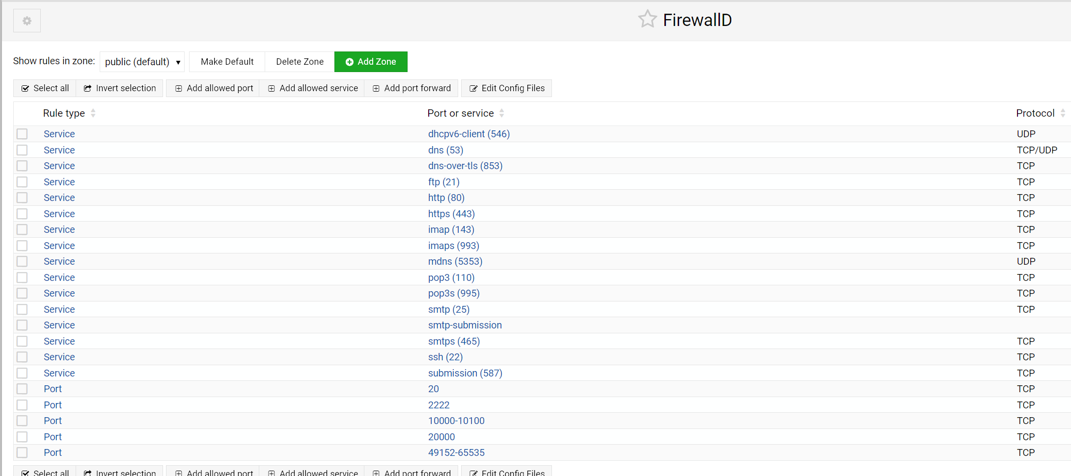

Here is a screenshot of my firewall settings.

That screenshot looks fine.

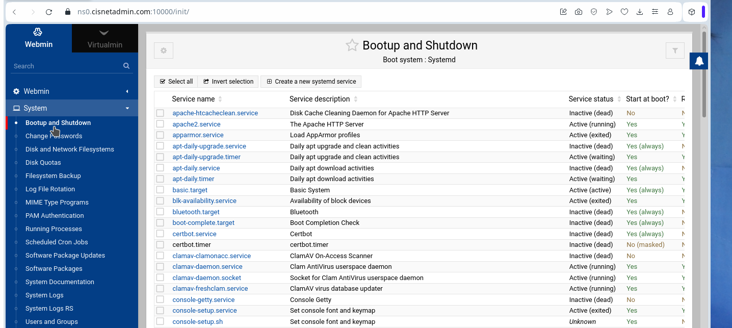

You might have two competing firewalls. ?
Check here to see what is running.
Firewald is the Virtualmin firewall that is what the interface controls.
Since same use the same basic service, but may be adding different rules at different times, stopping it will stop BOTH services.
You MIGHT be looking for pve-firewall
