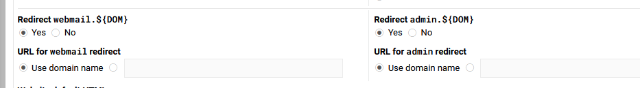

Yes, that is what is being requested, and we have discussed it before in the thread OP linked, and we decided we would add it. It just hasn’t happened yet (because nobody has implemented it yet).
reported here Improvements to subdomain redirects (mail, webmail, admin) · Issue #1169 · virtualmin/virtualmin-gpl · GitHub

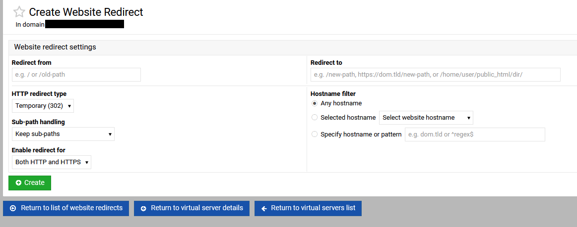

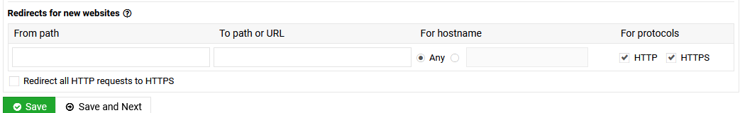

Just for reference in the new Virtuamin 8.1.0 there is a massively updated redirect page that you can use to create pretty much any redirect you want.
The help text will be updated in the next release with some examples but here is the GitHub link
