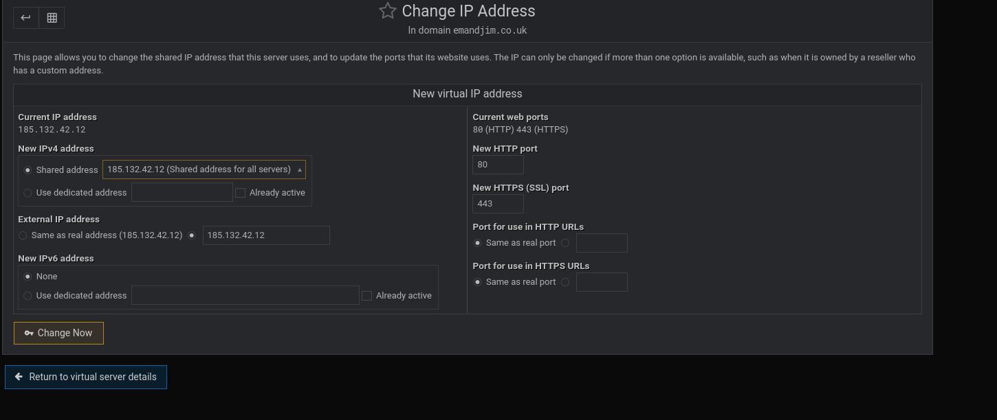

vmin->domain->manage virtual server->change ip address
Normally Virtualmin will detect the IP and ask to change it, ip4 anyway.

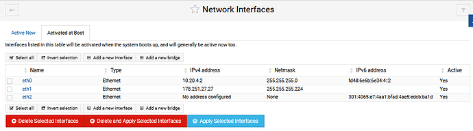

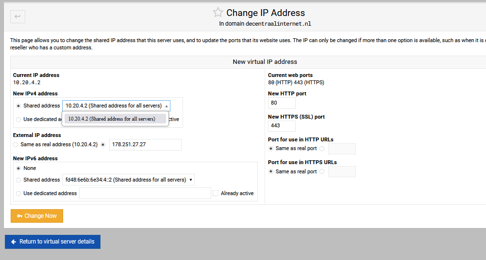

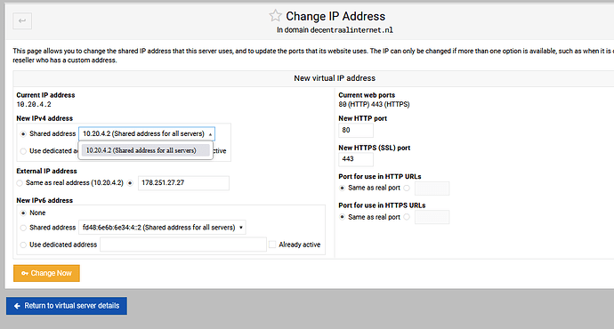

how come it’s come up with the wrong address 10.20.4.2 instead of 178.251.27.27 ?
Not saying that’s wrong, just unusual virtualmin not picking it up.

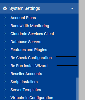

Maybe run recheck config
Thank you. I can’t seem to change that, when I handpick the 178 .251.27.27 address it says that’s already in use.

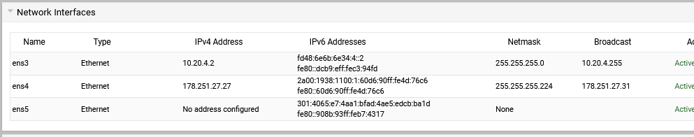

on Ubuntu I had loads of issues with multiple IP addresses & netplan … In the end I disabled netplan and reverted back to the original network config and virtualmin detected the correct IP … I don’t know if this is a related issue as the OP has multiple networks configured

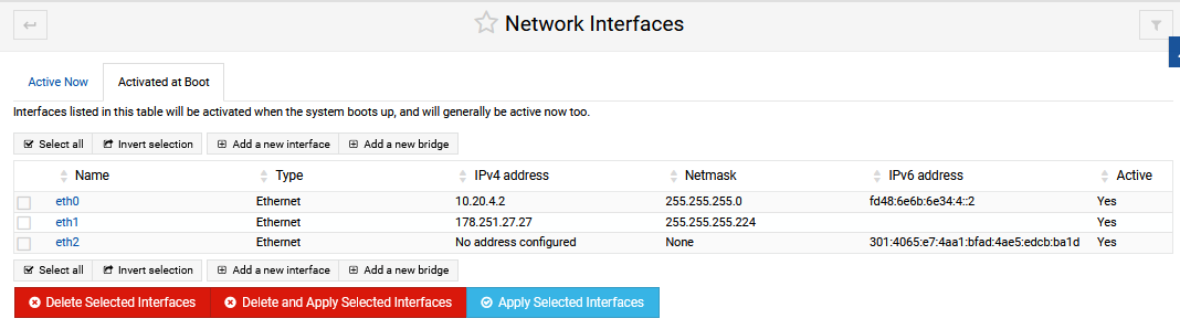

Ok, you have a internal and external address, weird.

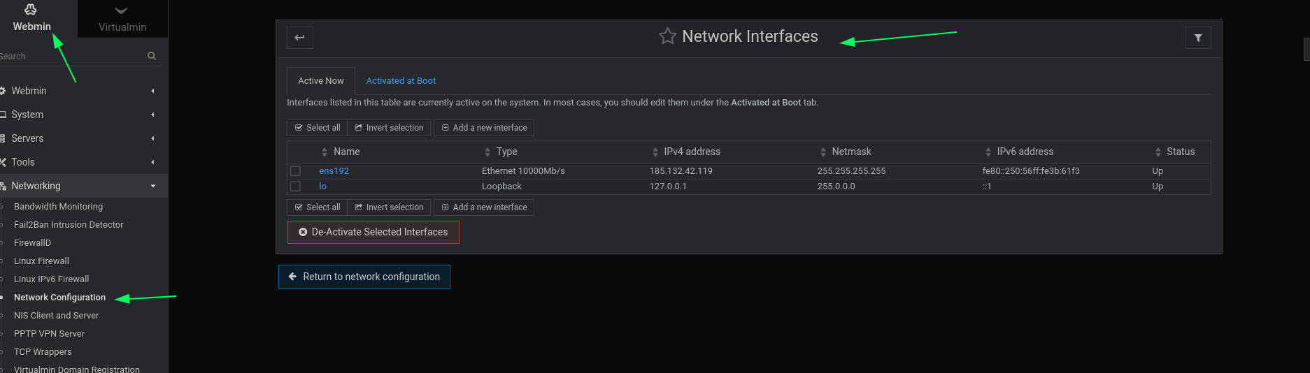

what does this page look like ?
Ah, it’s start to ring a bell. Not, not weird. This is a rackserver with 2 connections. It needs both since it acts as a node, where the other network is used for internal communictaions between nodes. I think that’s where it might confuse this setup.
I feel I should try and rerun the wizard and try to force him to ignore the 10.20 addresses. Until now I thought this was somehting that virtualmin created himself to handle internal requests…
Now only to find out where to find the ‘re-run wizard’ button :slight_smile:
ok, explains alot :slight_smile: On the way to fixing.

be aware this may not fix the issue, it may be a case of editing the netplan file manually, assuming your system is using netplan

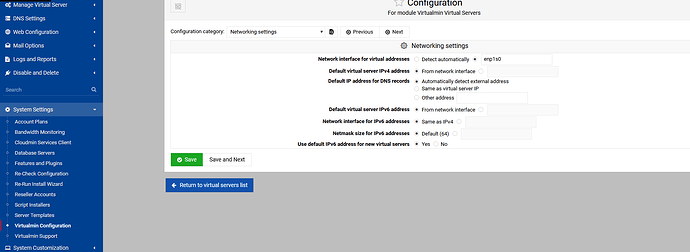

Not sure how you would make eth1 the main IP. I can’t remember selecting the IP in the wizard.

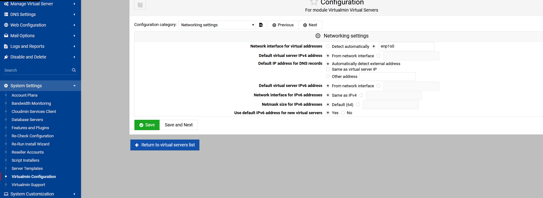

Maybe here
that looks promising … but will it change existing domains ? :person_gesturing_no:
Hopefully :slight_smile:
