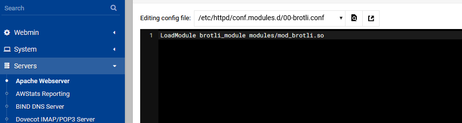

They make it sound easy
I don’t think these doc are for rocky like OS as I don’t have the a2enmod command and apache2
I don’t have Webmin->Servers->Apache->Global Configuration->Apache modules that i can see.
It do have a config file

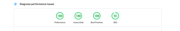

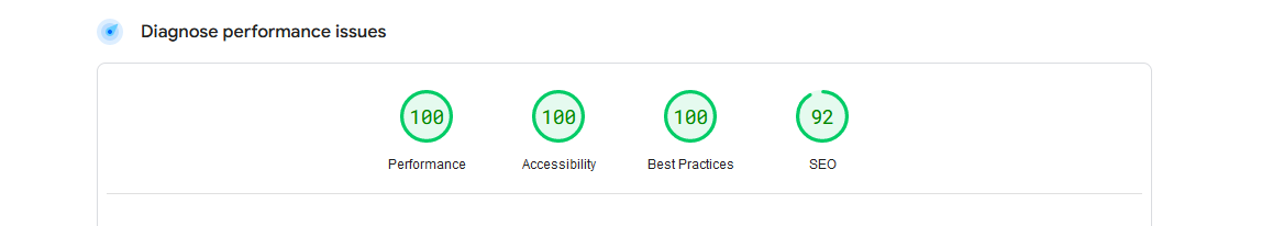

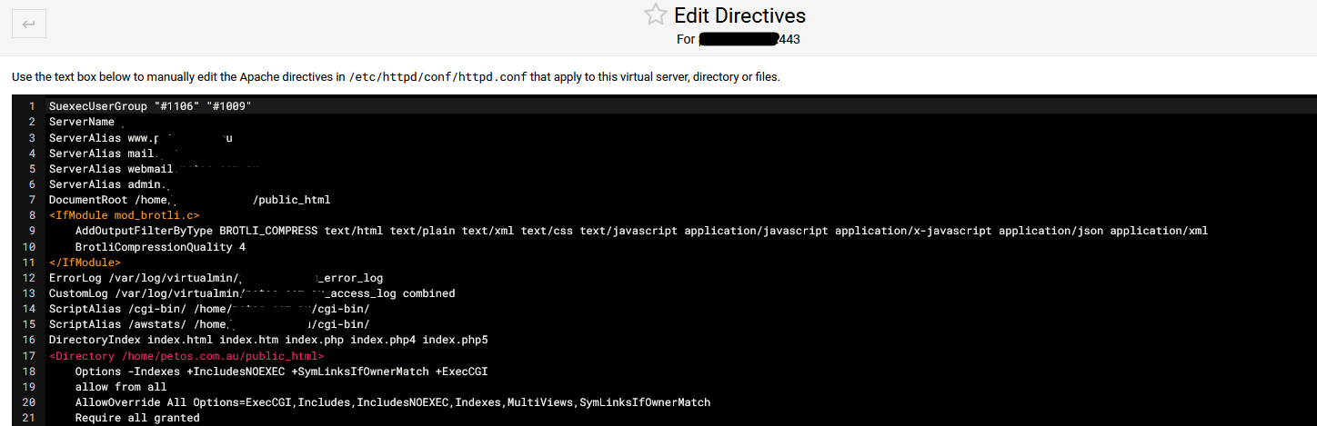

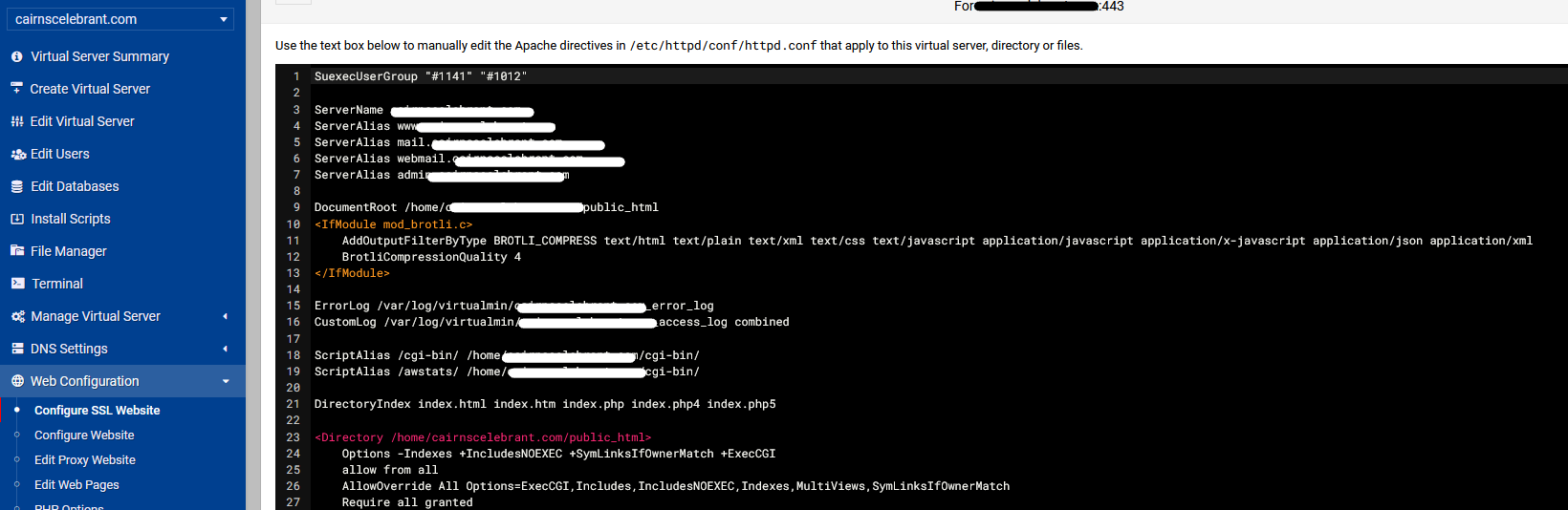

P.S. I added the code into one of the virtualservers and it worked (the site for testing you gave dosn’t work for me, found another and show great compression)
Improved page speed at https://pagespeed.web.dev

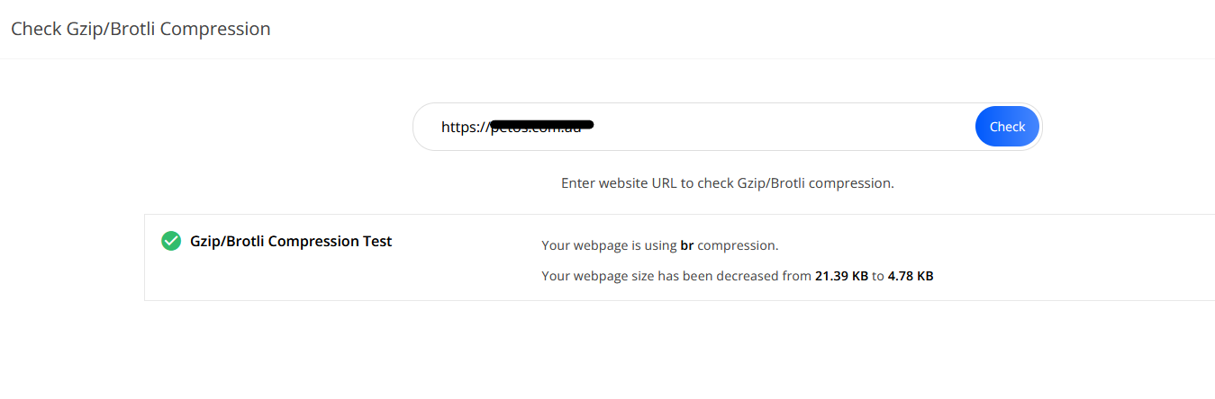

I made some more tests with different testing sites and it seems that my server is properly setup for both, I found 2 or 3 testing sites that do test both methods and they are telling me brotli is available and functionning, but still, the default method still seems to be gzip. For example Brotli Test - Verify Brotli Compression Support | KeyCDN Tools states that “Brotli compression is supported.”.

All I did was add here, Rocky9 had brotli already configured.
