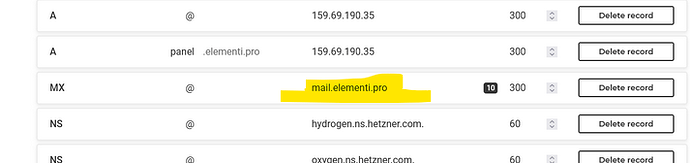

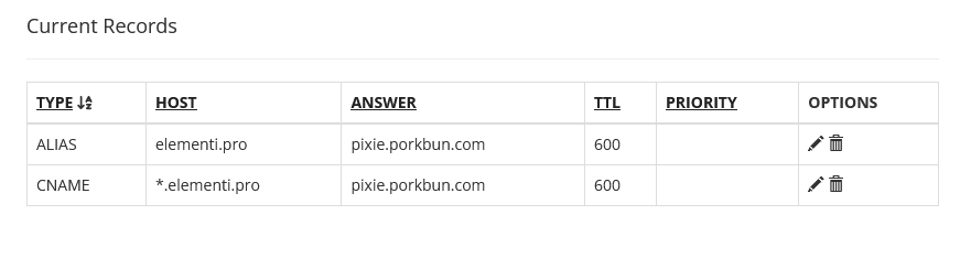

My domain register is Porkbun, my server is on Hetzner.

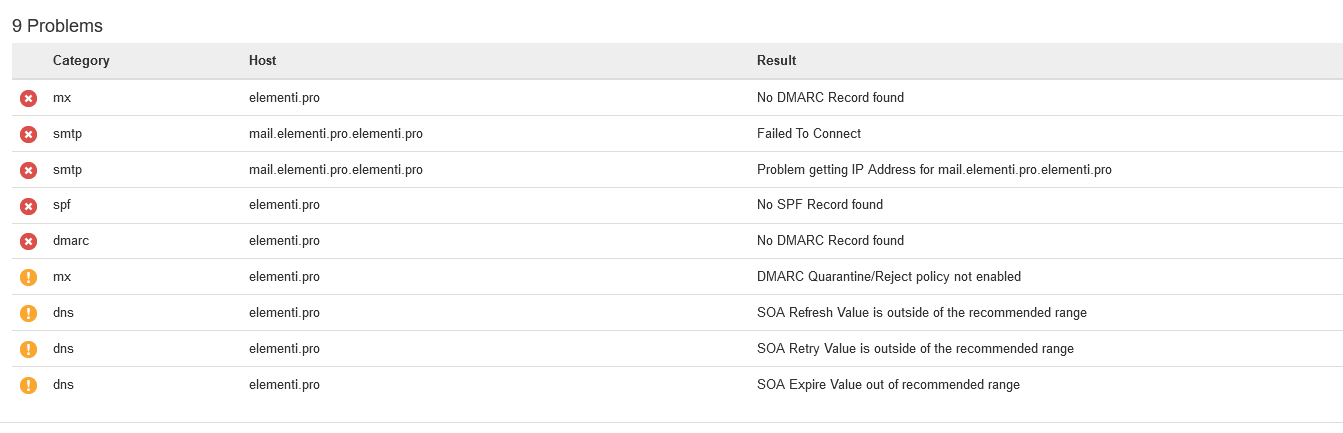

For the life of me i cannot get DNS settings right, always get errors on MX Toolbox and similar sites, Google is not receiving my emails.
Can someone please tell me what settings needs to be in Porkbun DNS, in Hetzner DNS and lastly in Virtualmin DNS? I don’t use Cloudflare.
I will attach screens from all three DNS settings bellow.
I would really, really, appreciate some help here.
Thank you

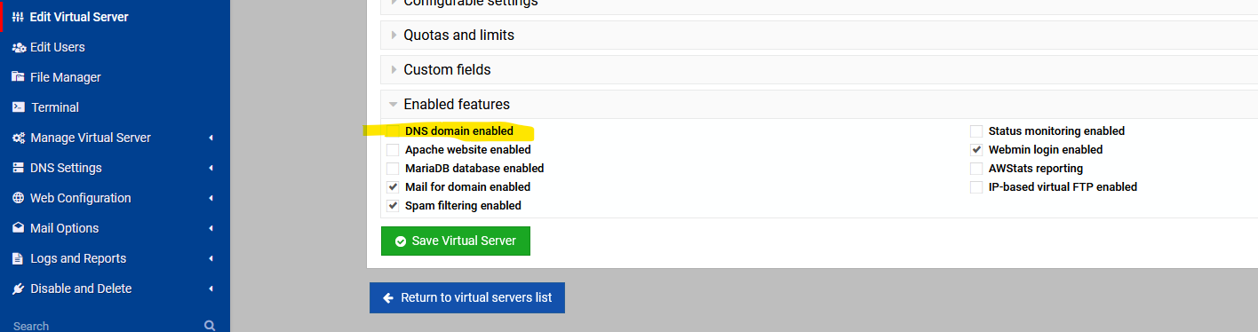

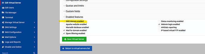

Ok, you seem to have DNS external to Virtualmin, so you need to disable DNS on the Virtual Server.
You can’t have 2 systems handling the the DNS. Its either external or internal.

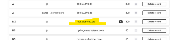

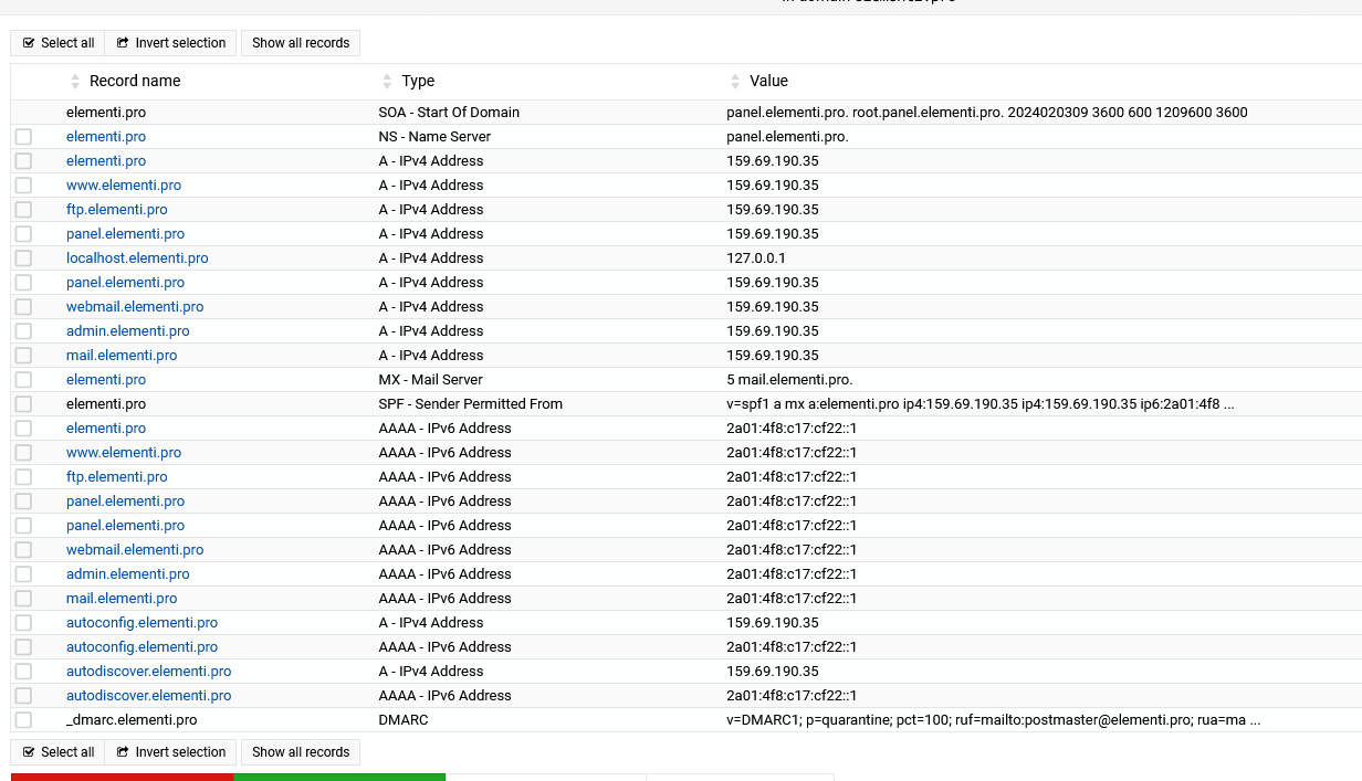

The MX record in the second screenshot, the address need to have a DOT on the end like the other addresses. ie “mail.elementi.pro” needs to be “mail.elementi.pro.”

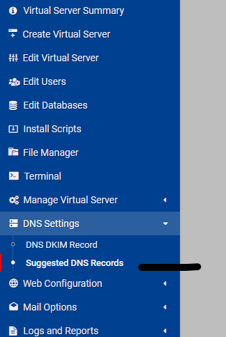

When you turn off DNS on the Virtual Server you will see Suggested DNS Records for you to copy to the current DNS.
There may not be a dmarc setting in the so use the one shown in the first screenshot of you first post.

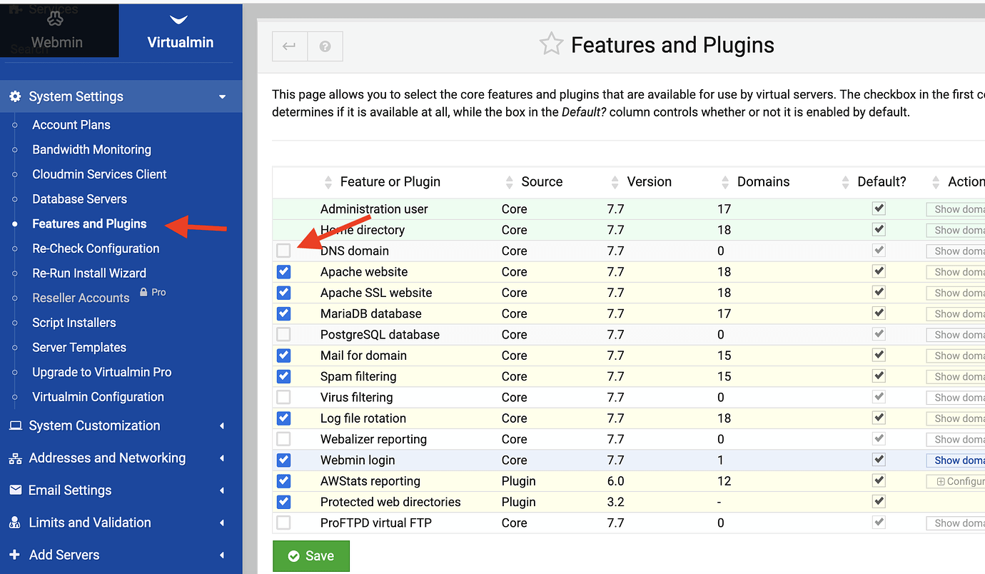

It never occurred to me you could choose external or virtualmin DNS on a domain by domain bases instead of all or nothing.
I always turn it off in > System Settings > Features and Plugins > and then the option does not show up in > Edit Virtual Server > since it is turned off server wide.

Ok, got everything sorted out. The only thing is SOA Refresh, Retry and Expire values that are hard coded into Hetzner DNS, cannot change them.

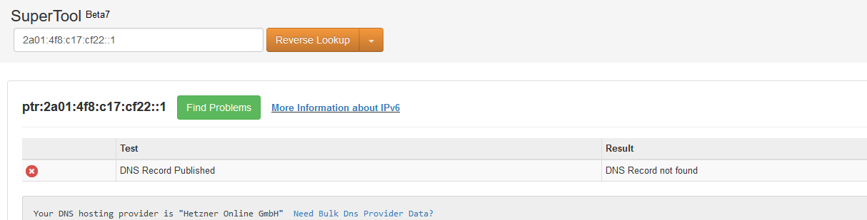

Just one thing, if you don’t have a reverse (PTR record) for you IPv6 record, I would remove it for mail.
else gmail (many other as well) will refuse mail when it sends on the IPv6 address.
