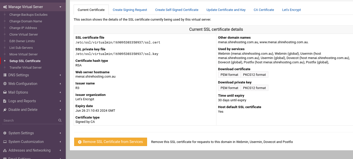

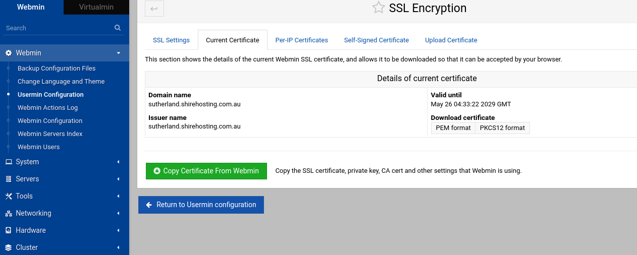

I have just installed a fresh copy of virtualmin, and are now left wondering how I manage the default ssl certificate. I used to just be able to choose the host name from the drop down menu > manage virtual server > set up SSL certificate. I was then greeted with both green and yellow buttons where I could copy or remove the default ssl cert to the other services like postfix dovecot mariadb. etc. see below

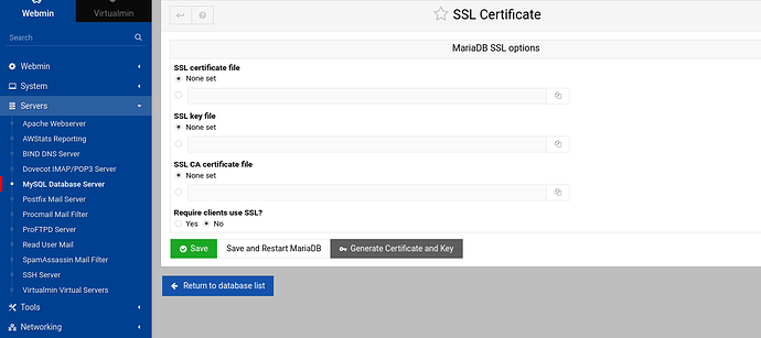

Now that feature is no longer to be seen, the default host name is no longer in the drop down box and from what I can see I’m now left chasing each service individually copying in the default ssl certificate that was set up to each service.

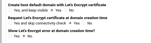

The host default domain is hidden from view by default. You can control this in System Settings ⇾ Virtualmin Configuration: SSL settings by using the Create host default domain with Let’s Encrypt certificate option.

Unless I’m missing something that is not exactly the same as we had previously. Yes it creates a ssl cert for the host name but it does not allow me to specify where to use that default hostname ssl. Eg it does not assign it to Usermin nor mariadb I now have to do this manually.
I would like the functionality we had before a button to copy it to the other services.
BTW what does “Yes, and keep visible” mean ?

Also how do I now recreate an hostname ssl after its been done automatically. as I’m not seeing a way once its been done the first time ?
That button was and still is available on the Manage Virtual Server ⇾ Setup SSL Certificate page.
It means it will be shown in the domain dropdown in the left menu and on other pages in the UI.
You don’t need to do it, but you could turn the default domain feature off and then on again using the Create host default domain with Let’s Encrypt certificate option to have it recreated.

Ok This is what I was after, it brings everything back. !!!

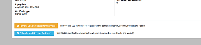

I don’t think it’s desirable. Do you mean to Set as Default Services Certificate, right?
@Jamie, what are your thoughts on it – making host default domain serve as default services certificate?
Sure, that’s not a bad idea. If we can create a default domain with a valid SSL cert from Let’s Encrypt, we could also copy that as the default to Postfix / Dovecot / etc…
Yes, thats what we do with all our servers … it makes sense to me
Alright, implemented here:
