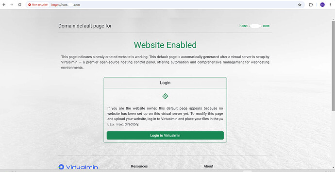

1 - I initially installed “JitSi” under the same hostname (host.domain_name.com) as the one previously used when installing “Webmin/Virtualmin (Apache2)” on the same server “Ubuntu 22.0.4”.
The installation of “JitSi” went very well except for a single SSL error (which is not the point concerned here, we will come back to it in point 2 above). But the problem is that when I launch the url host.domain_name.com, it returns me the Virtualmin home page that you see on the following screenshot instead of displaying the “JitSi Meet” page:
So I figured it was probably a conflict between the “Webmin/Virtualmin” and “JitSi” hostnames, so:

1°) B - I just after in “Virtualmin” on the same Ubuntu server, created a “New Virtual Server” with the old URL that served as Hostname and that was replaced above: host.domain_name.com so that it is only used for “JitSi” now.
But despite that, the error persists, that is to say that when you enter the URL host.domain_name.com which is now supposed to be redirected to the Home Page to the URL of “JitSi” and to be distinguished from the Hostname (now: hostserver.domain_name.com).
How then after these different efforts, succeed in redirecting host.domain_name.com to the home page of “JitSi” which, I remind you is indeed installed on the same server on the now Hostname hostserver.domain_name.com ???

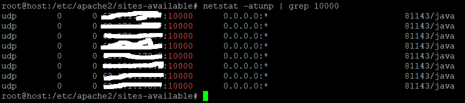

Are you JitSi is running ? from a quick look at their documentation JitSi requires port 10000 udp, which from memory, webmin opens perhaps run
netstat -atunp | grep 10000
To see what is listening on both 10000 tcp and udp. If you don’t have netstat installed you can use ss instead. I couldn’t find in the docs anyway to alter this port from 10000 udp so if webmin is using 10000 udp JitSi won’t run. Refer to the JitSi developers for possible work arounds
Thanks @jimr1 for your answer: netstat -atunp | grep 10000 returns me this:
I changed 10000 tcp default Virtualmin port to anothet reason why we can see only UDP
