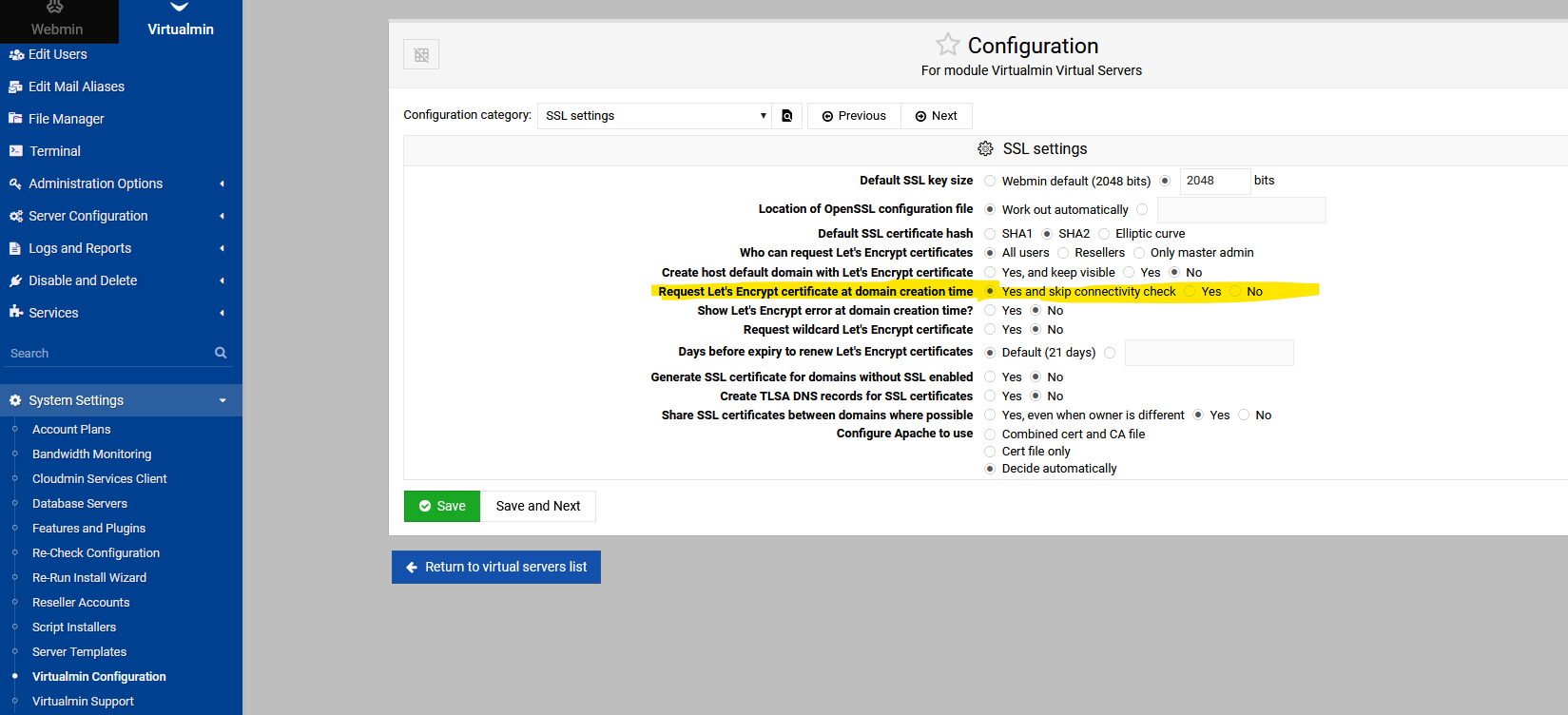

Is this not automated already by default? I never had to do anything for it and SSL for email always has worked fine with the letsencrypt certs?
Only one time I had to activate it due reasons on a later moment. This was just via Virtualmin → Server Configuration → SSL Certificate → Current Certificate and than click the button below: Copy SSL Certificate to services. And like that, it worked.
Yes, correct! It is all automated by default. @Brook You don’t need to do anything else!
