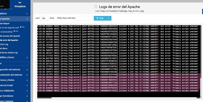

Any error in the php error log.
also make sure php is work ok
on the above domain you need to be looking at upload.php which is the script that your form posts the data too. As it is a php file & I assume you have php error logging switched on, view the relevant php log file to see what is going wrong.
The default files are located at /home/<domain-user>/logs and the default file name is called php_log. This may help you track the error down
Disable the “Apache website” feature in “Edit Virtual Server” and then re-enable it. This will regenerate configs and most probably fix the issue you’re having. Also, make sure you have the FPM mode selected on the “PHP Options” page.
My guess is upload.php was written for php 7.x and is now running on php 8.x and is failing through programming differences between the 2 versions
No, not really! This error comes from Apache’s FCGI/PHP-FPM before PHP runs.

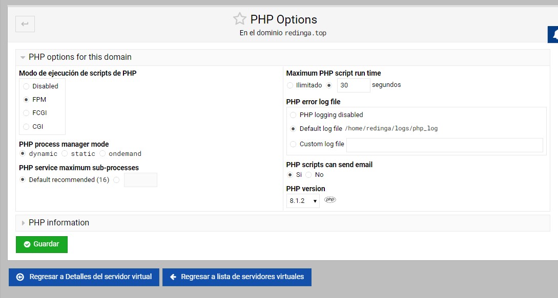

I already did it, I deactivated it and saved it and then I reactivated it and it’s still the same and the FPM is activated.

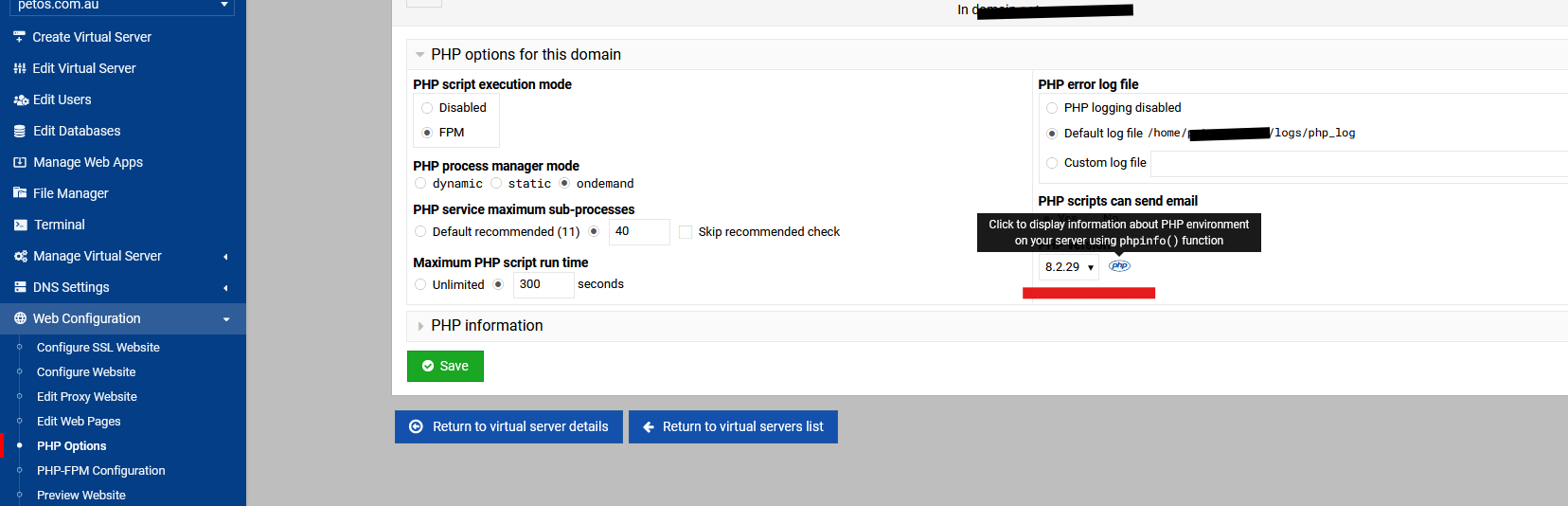

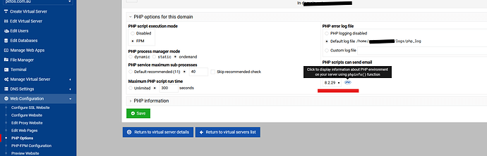

If you click the PHP logo on the “PHP Options” page, what does it show? Does it run as the correct user?
where?
and I checked the /home/redinga/logs/php_log directory and it is empty
In your screenshot, the PHP logo is right next to the PHP version dropdown.
