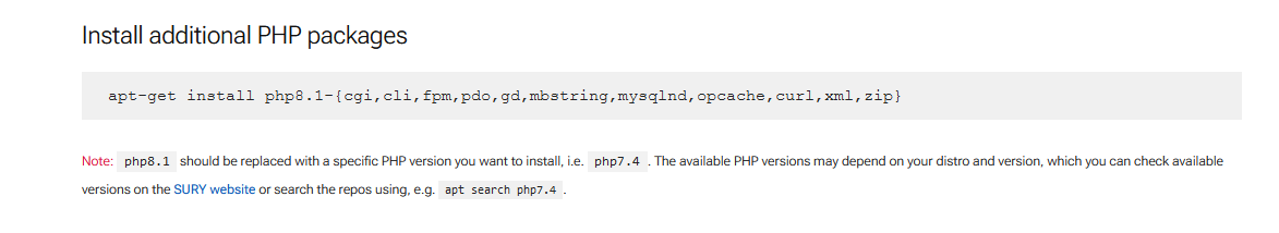

would you need to add the version?
Nobody had mentioned that additional versions of php have been installed so you don’t need to add the version as it will be the correct module for the installed version of php

Thanks! I don’t need this, I just need intl
Hi, what do you mean?
I already installed PHP 8.1, and don’t need other versions.
I just want to add intl

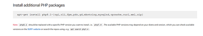

I didn’t mean that whole line.That from the Multiple PHP Versions docs, and IF you used that to install php8.1 you would use that format to install the intl, ie apt-get install php8.1-intl, if its the php that came with the OS use apt-get install php-intl
Sorry for the confusion.
