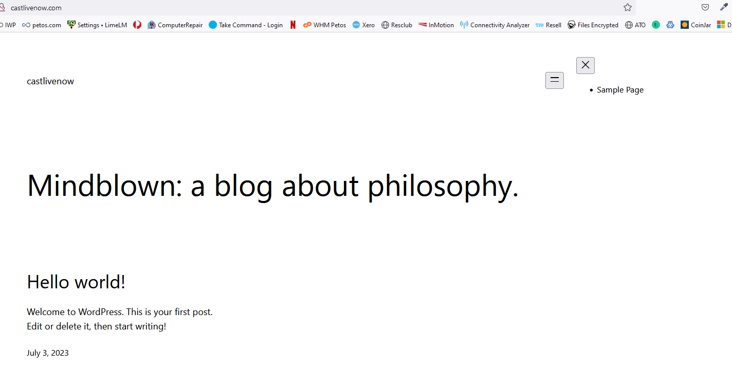

thank you for your help i have got it working now
finally

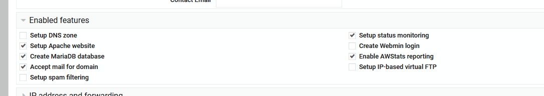

did you call the virtualserver mail.castlivenow.com
yes i have roudcube setup for the mail server too
you should call it castlivenow.com
mail www webmail are automatically created
ok how do i change it please
I’d delete it and create castlivenow.com
what do u mean im a bit confused
If this is new you want it setup correctly first, so delete the virtualserver mail.castlivenow.com
and then create castlivenow.com, dont’ forget to disable DNS on the new virtual server.
