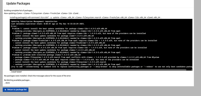

Help to resolve
OS type and version RHEL 9.5
Webmin version 2.610
Virtualmin version 7.50.2
Webserver version REQUIRED
Have you tried the suggest commands that shown on the bottom line.
That’s how I normally fix.
Tried but not fixed.

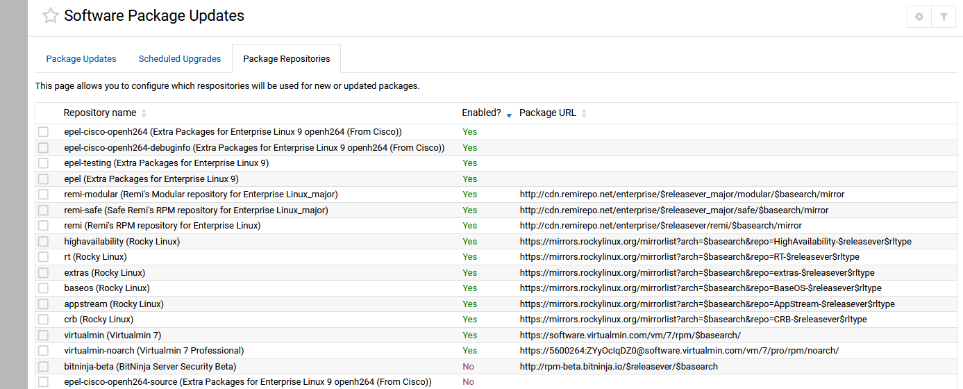

Otherwise maybe a missing repo. These are the ones I have enabled.
Also refresh your packages,

Since I run Rocky Linux and do not have a subscription to RHEL I was just checking to see if maybe there were versions exclusive to RHEL subscriptions.
