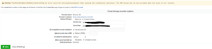

I am not sure what to enter for the host name for backblaze

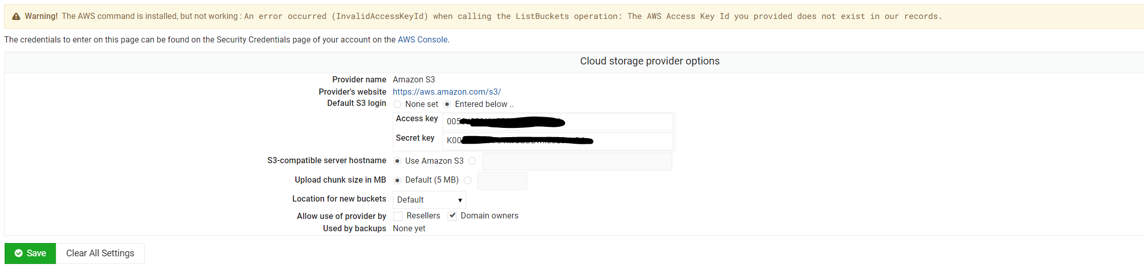

Thought i did everything correctly and i get this error.
" Warning! The AWS command is installed, but not working : An error occurred (InvalidAccessKeyId) when calling the ListBuckets operation: The AWS Access Key Id you provided does not exist in our records."

did you setup IAM user name
I notice they don’t use IAM roles, that could be the issue.
Do you need to mount the google drive or the vps?
I did not, thats probably my issue
Did you create a key?
