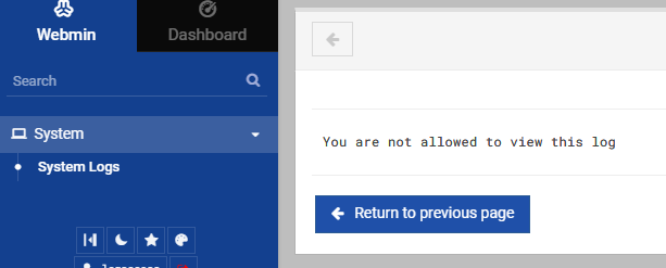

Tried as you suggested.
This user has access to SystemLogs and modified the ACL like so:
But when I log in as logaccess user I get the following error:

When I set the specific log file like so:
I get:
If I set the “Can view and configure Log files” to All I do get the syslogs for all the sites. I only want the user to see the logs for devnet2023 - do I have to add this loguser to my vs - not sure how to set up the permissions correctly?
