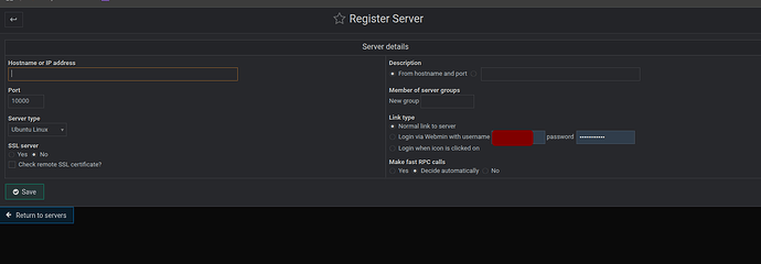

Asa mentioned, I added the remote Webmin server to the master Vmin server.

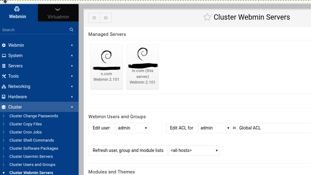

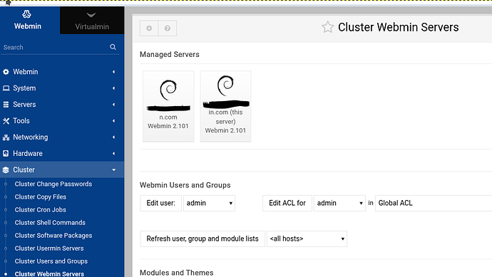

Webmin → Webmin Servers Index is where you add your new server
Cluster → Cluster Webmin Servers is where you add a server to the cluster

Clusters requires login via Usermame/Password for root.
My VPS host doesn’t allow username/password login for root, it has to be via SSH keys.
Webmin Servers is OK with ssh keys, can Clusters be changed to allow that too?
Should this be where I add atstaff?
This has nothing to do with clustering, just use a privileged webmin user to login with, remember this is not using ssh to communicate it’s using webmin
