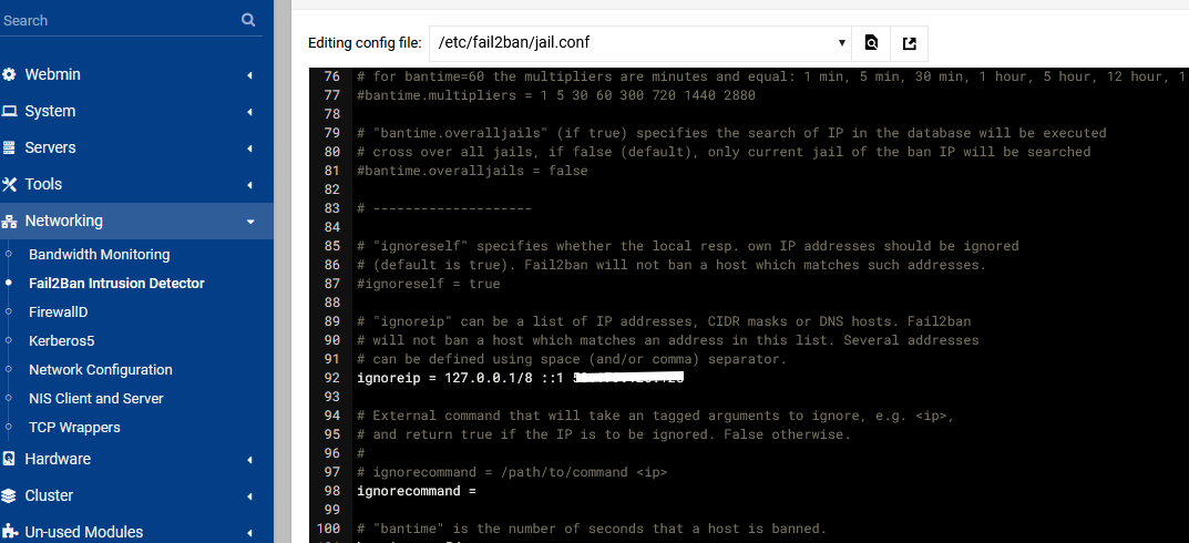

Is there any fix ? I thought adding my home IP to the global ignore would be enough.
Check first the ip is in the list, it maybe something else.
you mean here
Nope IP isn’t listed there and I do see my IP in the list of “never ban” IPs
Right, must be something else, not sure what else.

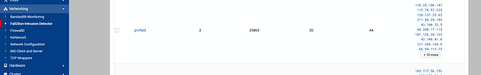

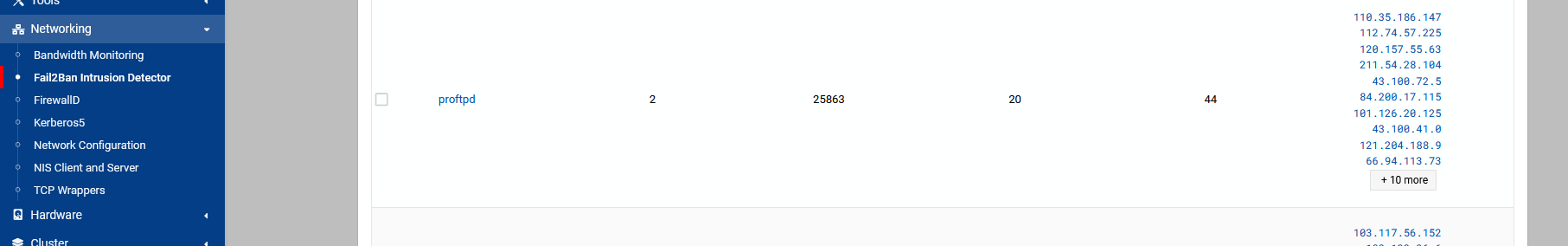

Maybe check the FTP logs.
So you can’t access web site too, does sound like a firewall issue.
It doesn’t sound like fail2ban to me. If they successfully logged in, fail2ban would have no reason to block them.
Right when I do a bit of heavy FTPing, I lose access to the FTP, Virtualmin, and the main website. I checked with the VPS host and they tell me there is nothing there end blocking me.
Right I was successfully able to login. I thought it might be because I’m using passive FTP?

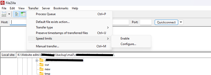

Maybe check the client ftp to bandwidth limit it, I can’t see it fixing the issue as your going through a provider and they should have heaps of bandwidth. But its something to try.
