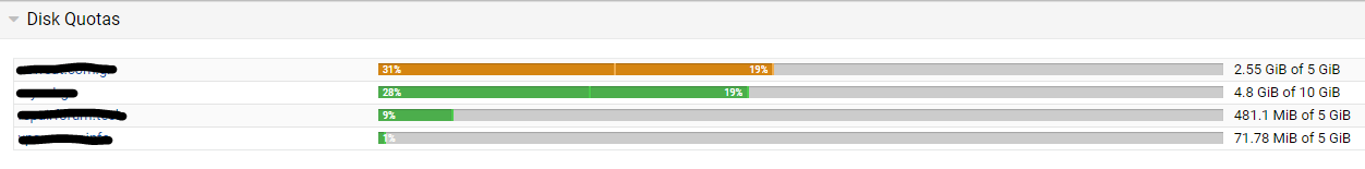

Hello.I have 50gb of disk space and 33.67 in use. The 4 websites I have in total are about 7.5gb. How can I see the approximately 26gb that are taking up space, in which folders - files? I don’t think the 26gb is from virtualmin? Can I use a command from ssh?
Webmin version 2.111 Usermin version 2.010
Virtualmin version 7.10.0
