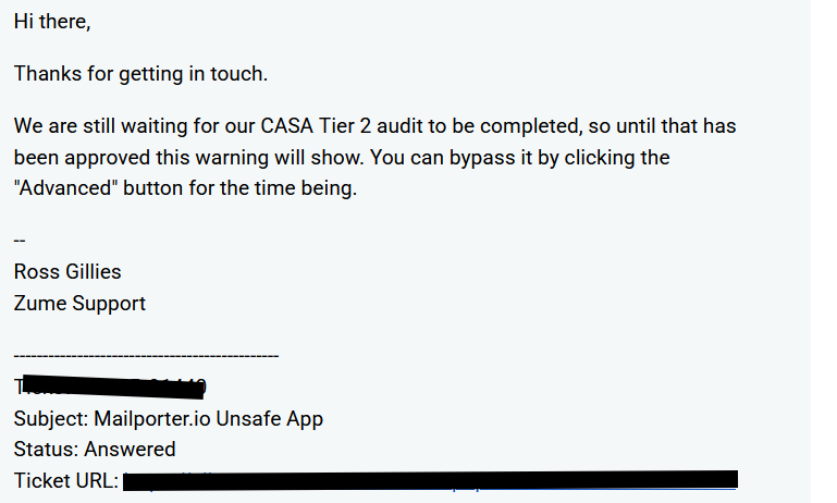

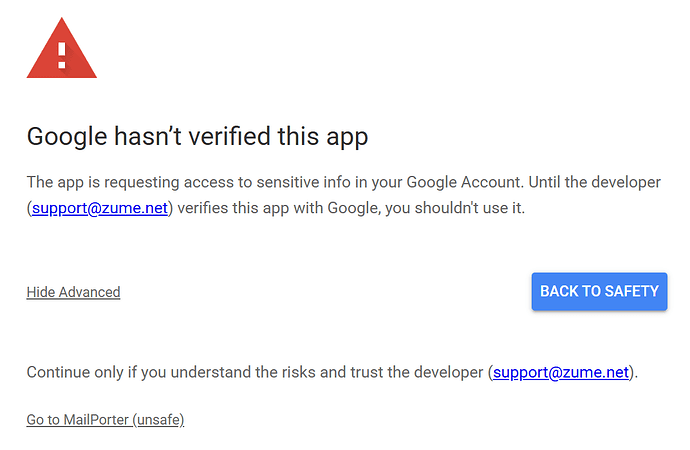

Doing it on your own google cloud instances avoids the security review too
