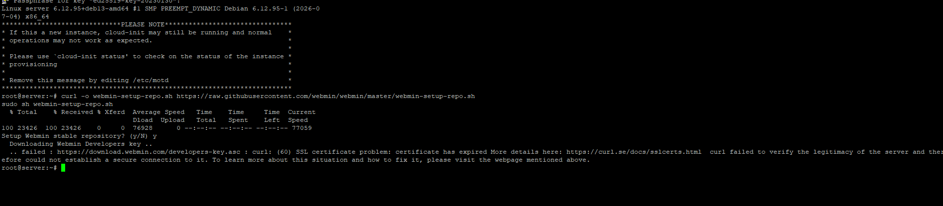

Followed the site instructions for installing webmin in Debian 13 and when I try to install get cannot find webmin or usermin
OS type and version REQUIRED
Webmin version REQUIRED
Debian 13
Whatever the current version is.
Got the repo installed
ran the sh webmin-setup-repo.sh script.
Now, all the /usr/bin/curl statements had to have the -k option added because the SSL certs all came back as expired.
Appeared to run successfully with the -k option.
running the apt-get install webmin said it could not find the module.
@staff something need fixing, I can replicate.
