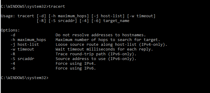

@ID10t - I am running Windows on my main machine - so I cannot run that command sadly, but thank you as well for the tip
Its tracert in windows.
