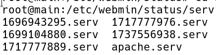

Since it ‘errors’ I can’t seem to find an option in the interface to yank it out. What file do I need to look at?
Look in /etc/webmin/status/services. See if there’s a monitor that looks like it’s for ejabberd, and just delete it.
It was a strange numbered file. There were a few in that format.
The 173… was the one grep said to look at. Removed and restarted webmin. Emails stopped. :smiley:
