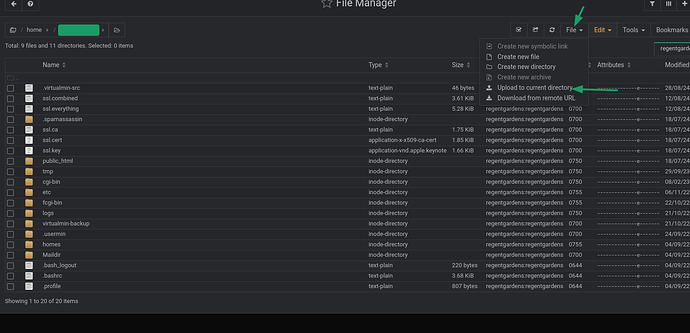

that won’t help both Virtualmin and filezilla are not coded in PHP. So you have tried uploading via the Virtualmin File Manager like this ?
or just using filezilla ?
I had not issue, is the server run on a VPS or at home or office?
i did like that doesn’t upload the file i wrote it upload same file 3 times one is 7.24MB, 7.39MB and 9.52MB file have 54MB
