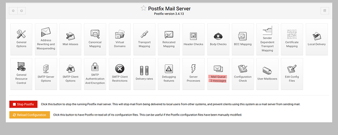

The fault has progressed. I’m no longer getting the error code on send. However, the emails are now Queueing in the postfix mail server.

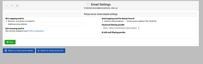

Try at email settings to send from Virtual Server IP (last pic)
If not, investigate sendmail (iptables - Port 25 blocked but Firewall is off - Server Fault)
Edit: if is a new server try to uninstall purge sendmail AND postfix, than just reinstall postfix with defaults. It may be a conflict between them two (one send to another or just wait for another and is time consuming to debug…)
Ok so now emails are just sitting in Postfix Mail Queue.
If you press on Flush Queue Postfix will try to send them

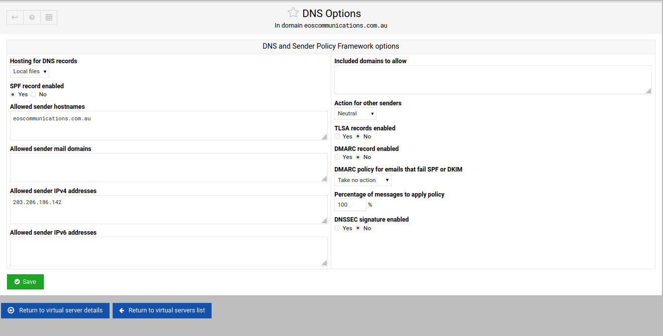

This all started because Im trying to please the Google overloard. Gmail keeps bouncing my emails. So I enabled some SFP added a little DKIM turned on a lot of SASL then nothing. I think I would be better off burning some incense and sacrificing a goat to please Google.
