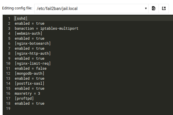

My current config-file looks like this:
Where can I see which banaction-parameter are possible?
all action files are here : /etc/fail2ban/action.d/
webmin → fail2ban → Match Actions
