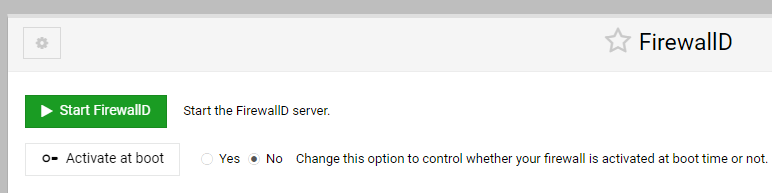

firewallD is disabled, I’m not trying to have both csf and firewallD. I want to know, can’t I have csf and fail2ban to in the vps?
Should I turn on firewallD with file2ban and remove csf?

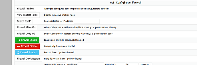

ON firewallD off CSF and I see good results??
I have a jail time of 3 minutes, so is it working properly now?

Fail2Ban is essentially LFD (Login Failure Daemon) in CSF. It does exactly what Fail2Ban does. There is no need to have Fail2Ban if you are using CSF, period!
As an expert in virtualmin, which one do you recommend I leave for better security? I see a lot of attacks on my vps postfix_sals
Hmm, I can’t see how that possible.

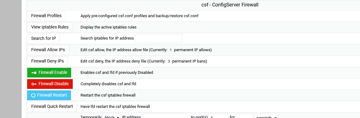

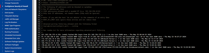

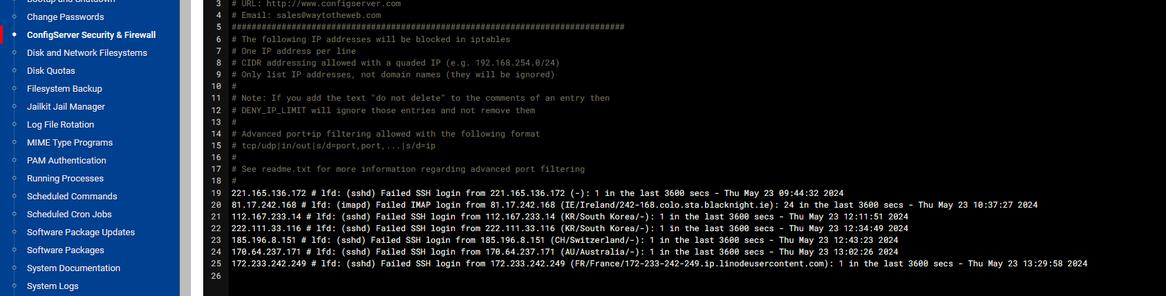

What do you see here. (bans are done with LDF)
Click into it

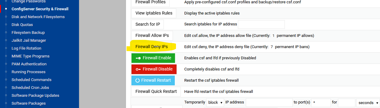

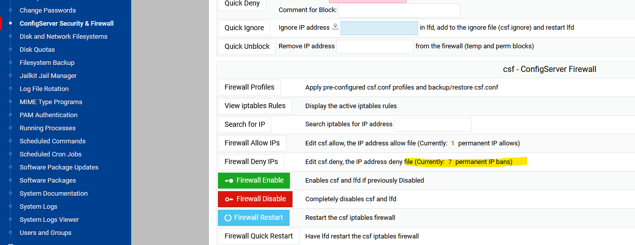

Edit csf.deny, the IP address deny file (Currently: 2 permanent IP bans)
What file is the second image you have uploaded?
click here
I am guessing the op disabled csf and enabled firewalld and fail2ban to get that result
