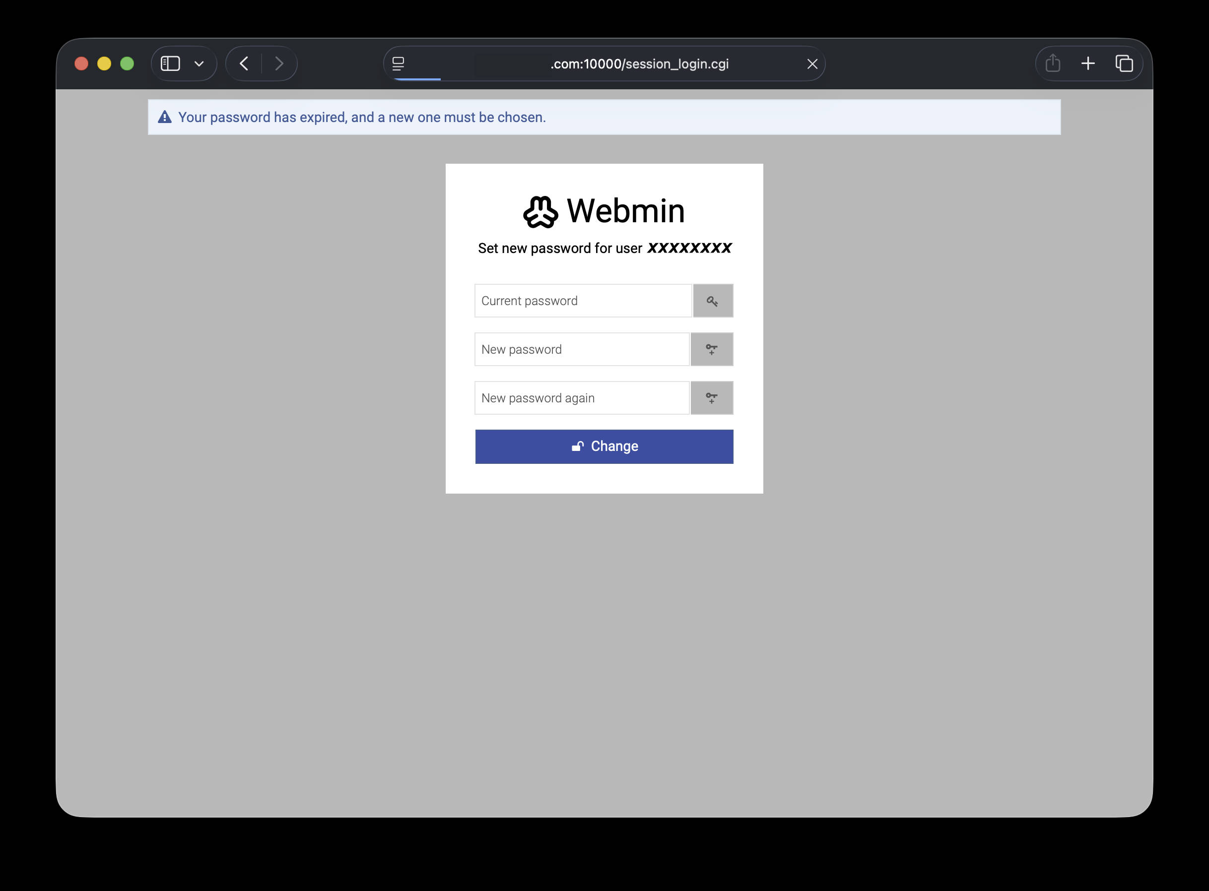

An interesting issue with Password Expiry enabled. Usermin is configured to prompt the users after they log in to change their password, as it has expired.
The page which appears asks for the old password and has two other inputs for new/verify password.
For an unknown reason, when the user logs in they may see this page for a second, then usermin redirects them back to the login form at “/session_login.cgi” immediately. They are not able to then update their password.
The only way I can get them back into their usermin is by going and manually resetting the password for them. At which point they don’t need to see the expired password prompt and can just log in as normal.
My question is, why is the password expired prompt page auto-redirecting and how do I make it stop so the users can reset their own passwords?

I am experiencing exactly the same issue.
The “set new password for user xxxx” appears but then quickly redirects to the login page.

The only way that I have been able to do a workaround is to change pass_maxdays=0 in /etc/webmin/miniserv.conf so that at least I can get in to do a manual reset of password.
The strange thing is that the form does appear so that you are able to make the change, but about a second later it redirects to the login username/password page.
