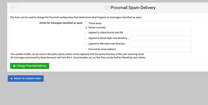

Is the default install behavior of the Spam system to NOT deliver spam classified emails to the spam folder in the individual email accounts boxes? I see that Servers/Spamassassin/Procmail Spam Delivery has: "Append to mbox-format mail file .. $HOME/spam" checked.
I have the ‘Enable Spam’ & ‘Enable Virus’ checkboxes checked for the virtual server, and the same enabled on all user/email accounts.
I was under the (possibly wrong) assumption Spam would be delivered to the users ‘spam’ folders.
If that is wrong, and I indeed want spam delivered to the individual users ‘spam’ folders, should I change the Servers/Spamassassin/Procmail Spam Delivery setting to ‘Deliver Normally’?

Is it correct for spam emails to be written to a text file instead of delivered to the spam mailbox?
The text file located here has the test spam emails I have been sending written to it:
/home/mydomain/homes/username/spam
The setting you mentioned above:
Virtualmin > System Settings > Virtualmin Configuration > Spam Filtering Options:
Other file or email address: $HOME/Maildir/.spam/
I found that

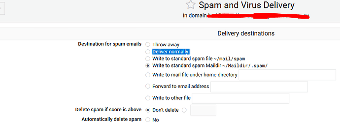

Virtualmin > Server Configuration > Spam and Virus Delivery has:
Write to standard spam: Maildir ~/Maildir/.spam/
Webmin > Servers > Spamassassin Mail Filter:
Append to mbox-format mail file … $HOME/spam
Are these all correct?
Maybe the last one (Webmin…) is not right?

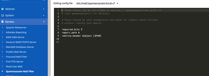

Thank you for the help, but in that location my config file is :/etc/spamassassin/local.cf and has these 3 lines:
ifplugin Mail::SpamAssassin::Plugin::Shortcircuit
endif # Mail::SpamAssassin::Plugin::Shortcircuit
rewrite_header subject Spam

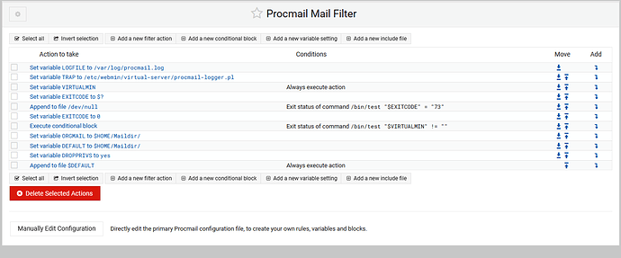

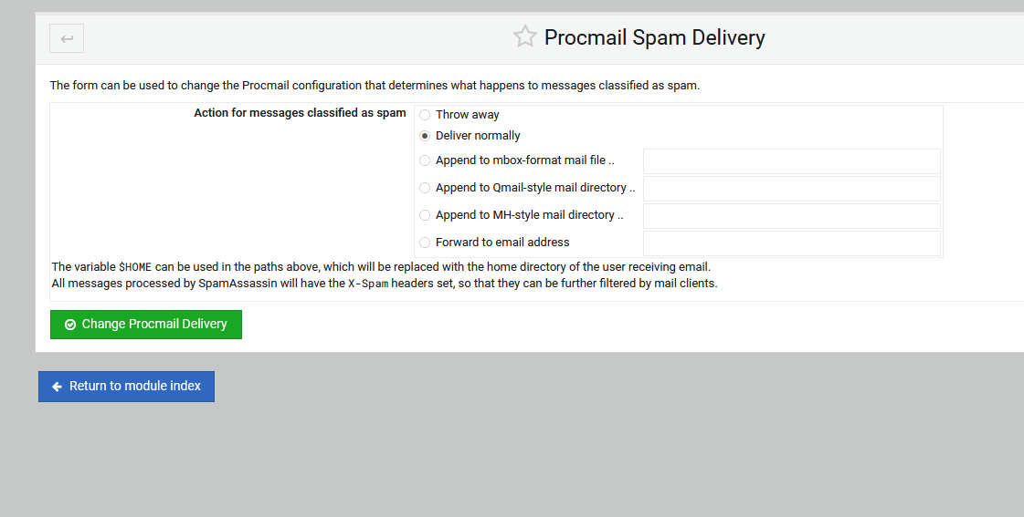

Can you do me a favor and tell me what you have set here:
Webmin > Servers > SpamAssassin Mail Filter > Procmail Spam Delivery

Thanks for posting the 2 screenshots, I am confirming my setting match right now

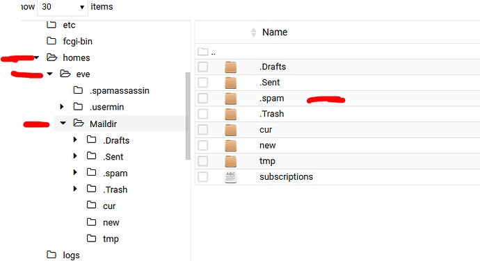

well spam should go to .spam folder, the file structure is like this

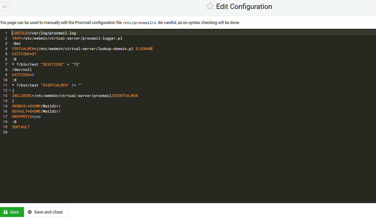

My procmail filter settings are the same, except for the last entry which says:
Append to file $DEFAULT Match regexp ^X-Spam-Status: Yes
Mine are not, they are going to the INBOX.
