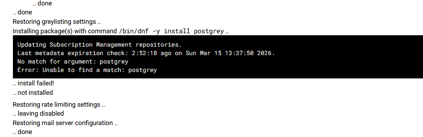

Error: Unable to find a match: postgrey
OS type and version RHEL 10.1
Webmin version 2.621
Virtualmin version 8.1.0 GPL
Webserver version REQUIRED

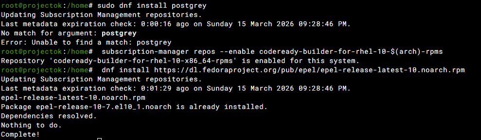

I get this error while restoring my backup.
Please help me to resolve.new installation of rhel10.1.
@Ilia @Joe please help
Do you have postgrey installed?
I don’t see it listed as available for 10 here:

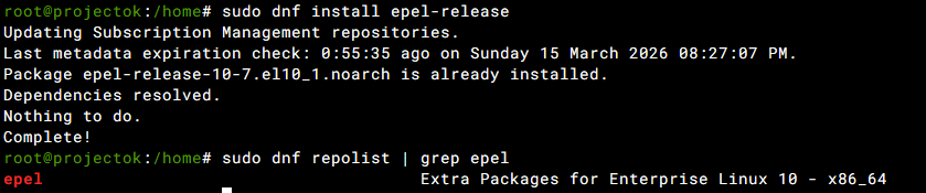

I do see you have to have EPEL enabled to get it though. I got there from here:

You are right. This is old backup.I need postgrey. If possible how to install it manually or via virtualmin?If not which feature i have to untick in this?
backup i got it from rhel9.7 server but backup is very old. this backup 1st time i got it from ubuntu 22.04 then migrate to rhel9 till rhel9.7. now i am trying with rhel10.1.This backup was 2019.

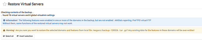

Postgrey isn’t available from EPEL on RHEL 10, and I think it’s sort of deprecated, as it hasn’t had an update in several years.

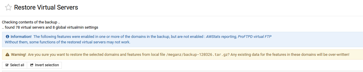

As for ProFTPd Virtual FTP, you almost certainly should not have enabled that feature in the first place, and you definitely don’t want it enabled now. It’s a worse than useless feature (it stopped being useful/necessary 10+ years ago when ProFTPd got name-based virtual hosts via RFC 7151: File Transfer Protocol HOST Command for Virtual Hosts).
Not sure about AWstats, but I guess it’s also been removed from the Rocky and EPEL repos in 10. There are better analytics options available these days.
Did your restore fail, though? What actual problem are we trying to solve?

I have checked too. Postgrey isn’t available from EPEL on RHEL 10.

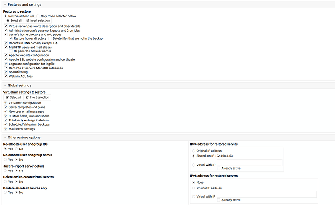

Please help me restore the backup. I got this error while restoring the backup
Which option do I need to untick in the picture below to restore the backup completely?

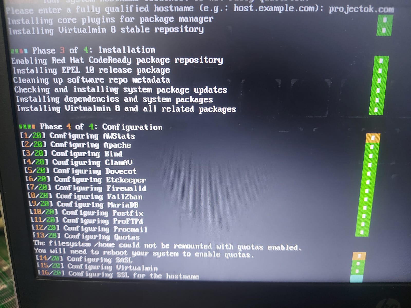

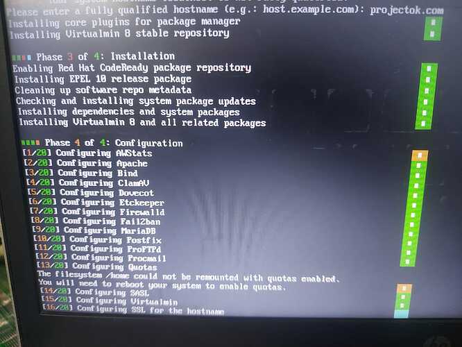

I get this error while installing virtualmin. Please check 1 & 13.

Don’t change the subject. If you have questions about the install, make a new topic. (And, please read the message for line 13…the answer to your question is right there. Probably. Though it is also possible you’re on a container-based virtual machine that can’t support quotas.)
