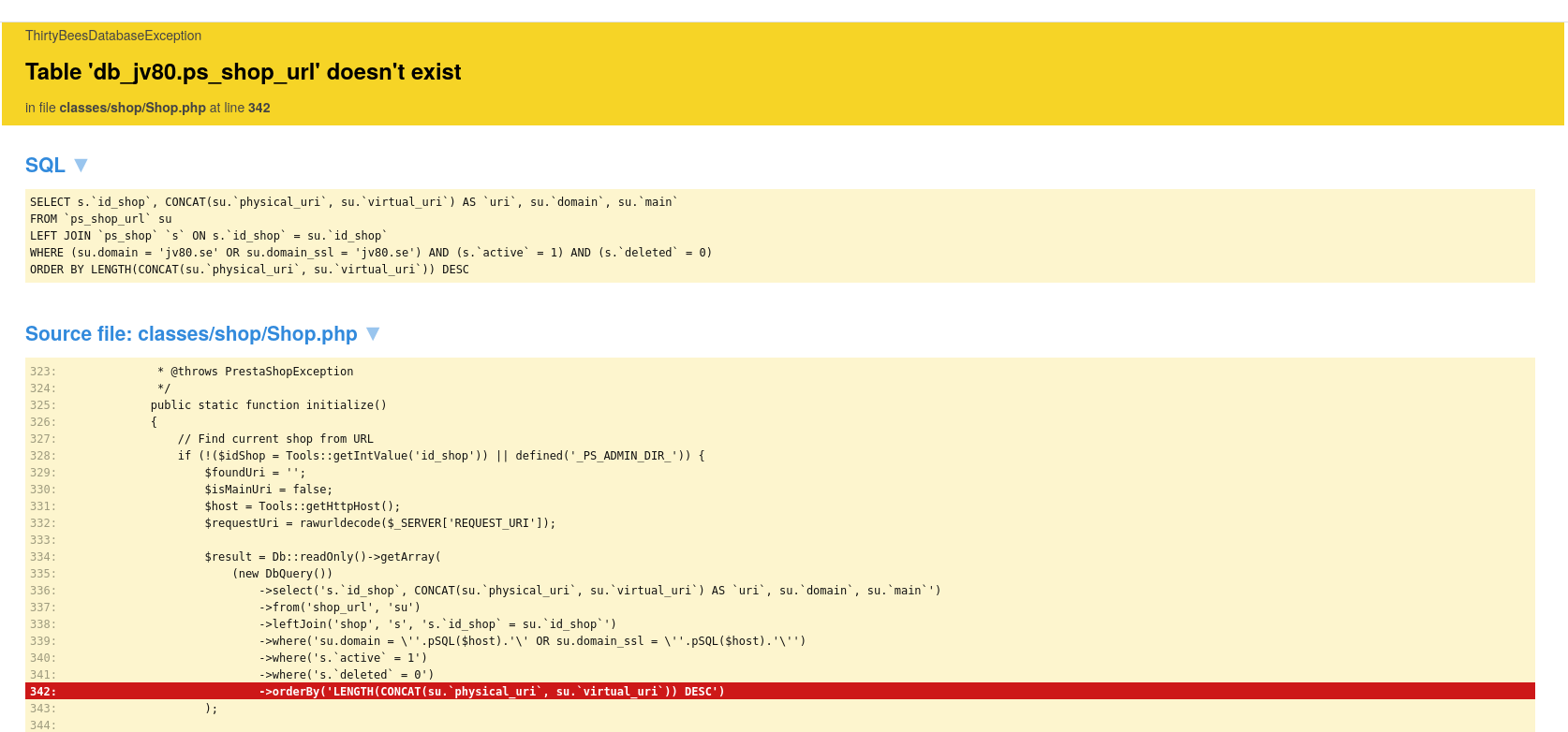

I try to transfer a domain between 2 Ubuntu 22.04 servers. After transfer I get a 500 error. The error say that one table in the db is missing. After check it turnes out true. I have tested to transfer 3 times and get the same error. Also when I backup and then restore the backup I get the same error. How can this happen

I have checked. The source db has 120 tables and the destination has 119 after transfer. The missing table is ps_shop_url

Its a Thirtybees webshop.
So, as I had presumed, it is the app that is at fault. So really one for the devs at Thirtybees. that code should first check for the existence of the table (and possibly create it and it’s indexes) before attempting to perform such a convoluted join. or something else is potentially deleting it further up the code. but only the devs will know what the purpose of this code is for (as so often with code it lacks documentation)
