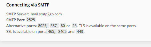

Yep tried all the combinations. Using ttps://www.smtp2go.com
Connecting via SMTP
SMTP Server: mail.smtp2go.com
SMTP Port: 2525
Alternative ports: 8025, 587, 80 or 25. TLS is available on the same ports.
SSL is available on ports 465, 8465 and 443.
Best I can do is the .. sending failed : SMTP command rcpt to: xxxxxxx.xxxxxx@gmail.com failed : 550 relay access denied - please authenticate
