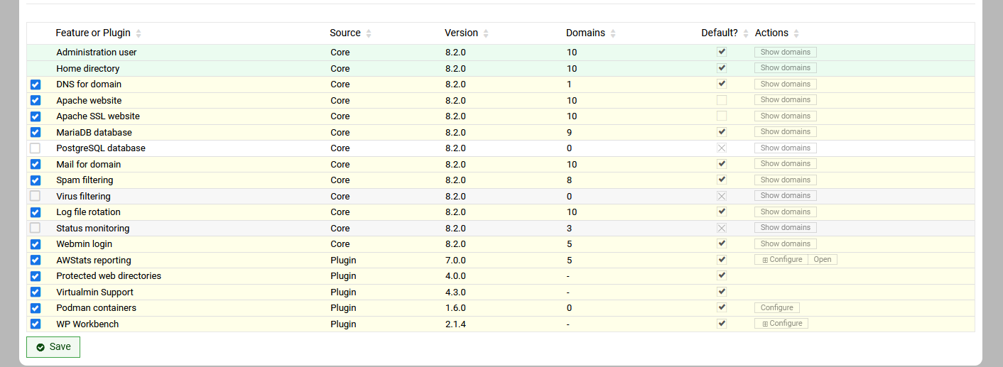

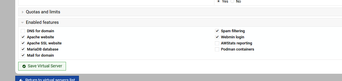

I am also not seeing any mention of the new podman module
I see it.
How did you both upgrade? Did you use the Virtualmin UI, or did you use SSH?
You can easily install it by running:
apt install webmin-virtualmin-podman
Just the normal Virtualmin UI method.
