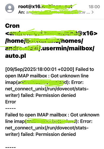

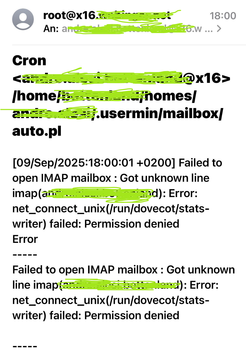

So i have this problem that i basically can not use usermin anymore. since i mostly use rouncube for mails i did not notice until now that login with usermin does not work anymore. maybe it is the case since the last update of usermin. the cronjobs with the auto.pl entries created by usermin also show the same permission errors. same as the login - which is:
Error: net_connect_unix(/run/dovecot/stats-writer) failed: Permission Denied

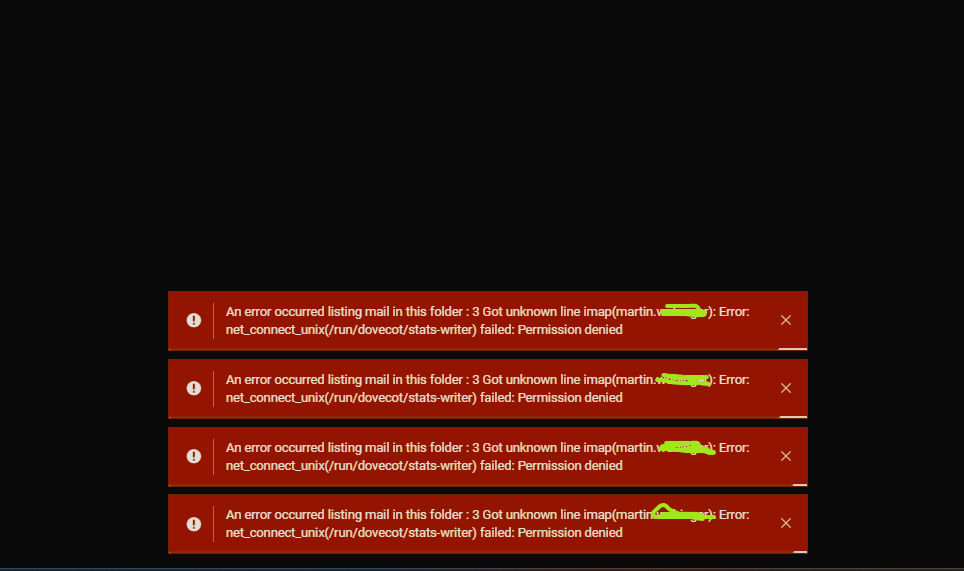

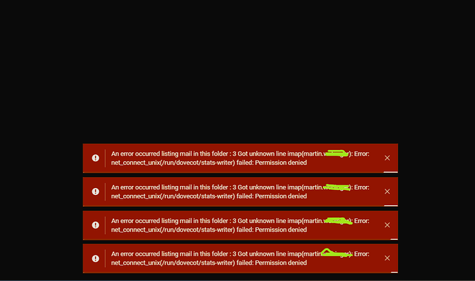

so when I press the “Login to Usermin” - as I usually did without any issues - in the Virtualmin Menu and Usermin loads up it shows the error messages on the bottom of the screen.

i got a message today from one person that got a domain on that specific server that complained about getting spammend with
that mail from the attached screenshot. he reported today two hours after the update of usermin. maybe there is the connection.
