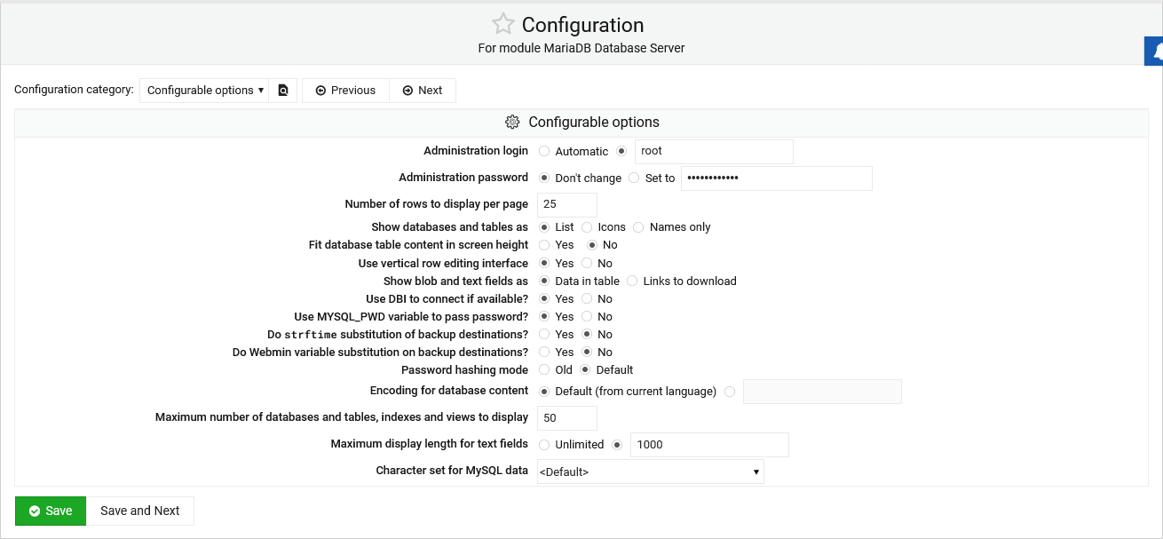

are both systems using the same database type, like MYSQL or MariaDB?
Are both systems using the same setting for storing passwords (hashed / plaintext)? You choose this in the post-install wizard.
No, VPS old use MySQL, new one MariaDB
I don’t remember that, how can I check it?

If you have different database servers on the two VPS’ then @stefan1959 has put you on the right track to troubleshoot the issue. The password hash is not important under the circumstances.

Im attaching the module config screen for the new server, it’s the same in the old one with MySQL.
