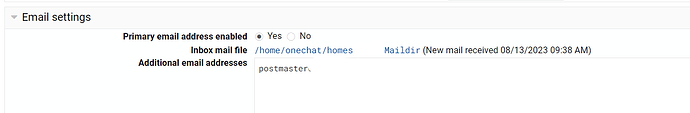

This user was edited after creation to add the additional email address of postmaster@1domain.co.uk but postmaster@1domain.co.uk is a default alias.
(have I misunderstood this and somehow created 2 postmaster@1domain.co.uk users/aliases? If so why can I only find one under “Edit Mail Aliases”?

@jimr1 As I said no direct editing of Postfix only the setup page of the user as shown in the
This may be relevant.
