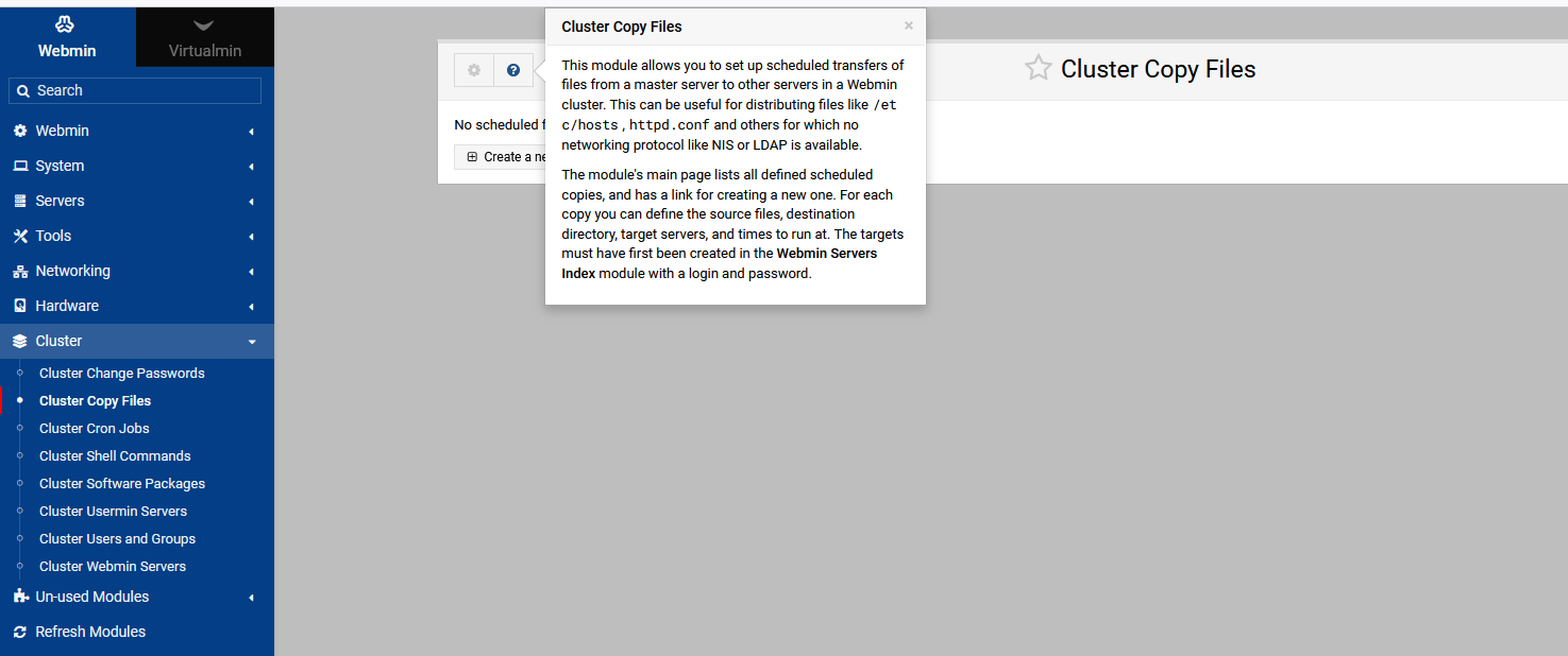

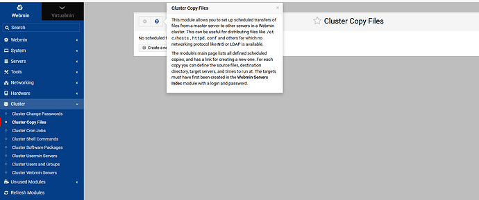

Cluster has copy files, maybe that what you are after, I’ve never used it.
